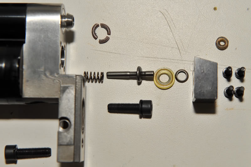

Agree, it's the seal with the brass bushing insert behind the block with the four screws. It's a $4 part and takes about 10 mins. to replace. Typically, you notice that the sound of your rifle firing changes and eventually gets to the point that the pellet won't impact the target at 10M. There is still some air in the chamber that isn't expelled until you pull the charging handle again. Here is a photo that shows the parts. Just put them back together in the right order. Good luck!

45ACP223, what is this three pieces oring-look-a-like?

In the photo I posted (came from somewhere on the internet), the o-ring in 3 pcs. must have broken when they removed it. An o-ring is suppose to be a complete ring. Also note in the picture that the valve is positioned backwards in the photo. The long end goes toward the firing pin. Here is a link to a replacement tutorial that zanemosley recently posted.
