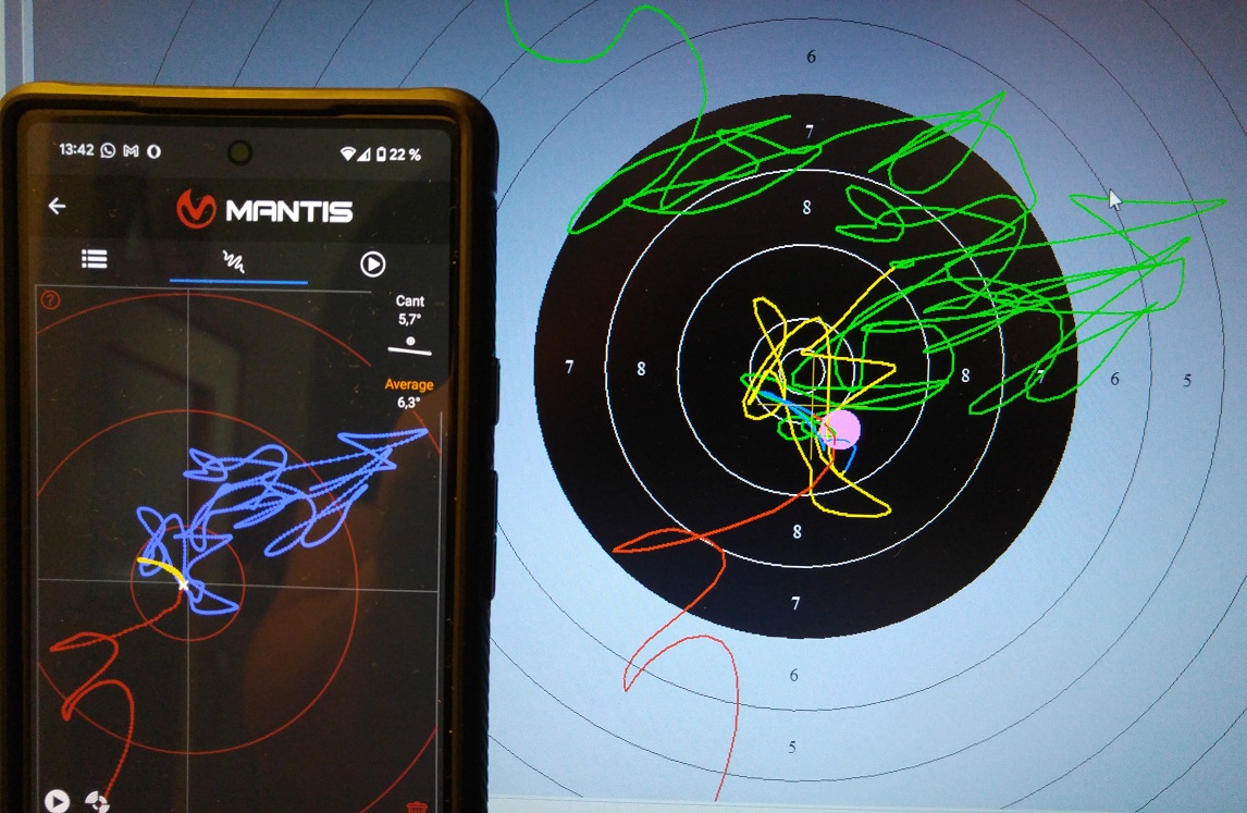

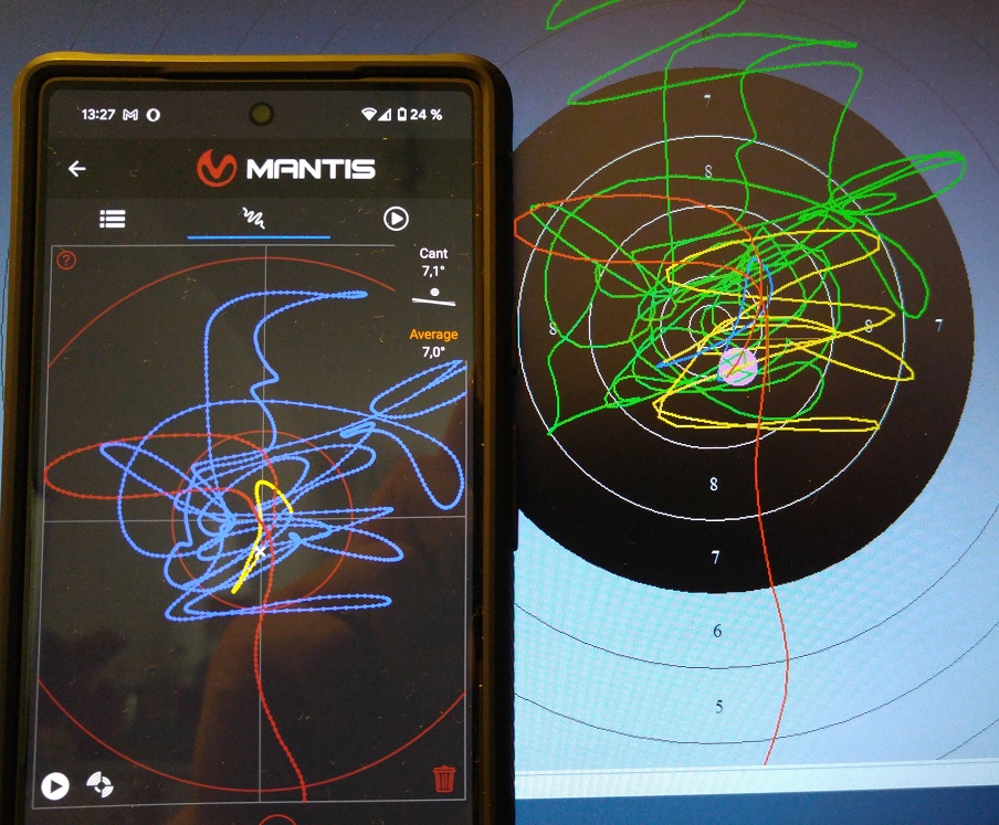

I have Mantis X2 and Scatt WS1. I tried them both together on Steyr EVO 10E and I can confirm, that in terms of sensitivity, there is almost no differece. But Scatt gives you more info obviously...
I would say that Mantis X2 is good for dry fire training (on air guns you can use it even for live fire) when you don't want or can't use Scatt.
