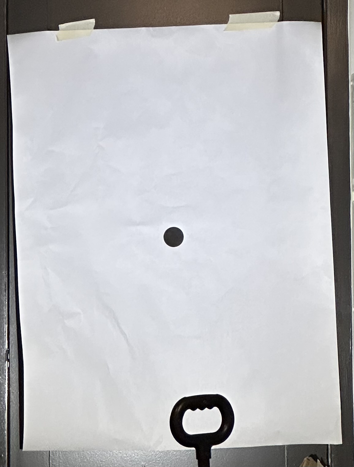

I can’t get my SCATT Mx-W2 past calibration. It can detect a shot as indicated in preview mode and the sound bar being exceeded but it won’t read the target no matter the distance or lighting
I have SCATT’s proprietary LED Box and tried it in total darkness and with light. Different backgrounds from light to dark
I’ve tried a paper on my wall per recommendation with 1000 a lumen light
I have a laser measuring tool and have tried different distances from 2 to 10m, adjusting the SCATT along the way. I even tried shooting it by just adjusting the focus dial while at different distances, slowly, to just try to get past calibration
SCATT USA hasn’t picked up the phone nor have they answered emails
I’ve also used the SCATT Expert in iOS, MacBook, and PC. None of them will go past calibration
Any recommendations?
Below are some examples of what I’ve tried and what SCATT see’s
What SCATT see’s in preview

After trying a few more targets, distances, and lighting—I thought, why not give SCATT a large white backdrop?
So I printed a bull on a 36x48 sheet of paper at FedEx, adjusted lighting to 1000lux(not lumen!)
And it WORKS! So happy I can get it to work now!
Now to find the smallest amount of paper that will work for travel
