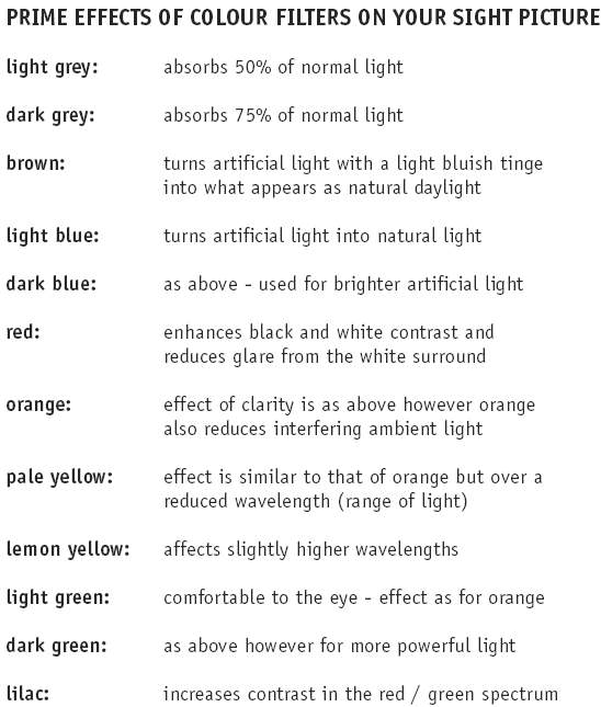

Also, try page 11 of the latest Gehmann catalogue available here:
http://www.gehmann.com/english_final/downloads.php
Or see the attachment to this post.
- Effect of coloured filters
- Effect of coloured filters.jpg (48.24 KiB) Viewed 4315 times
