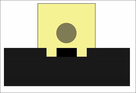

Hi.
I shoot air pistol & use a sub 6 hold. When dry firing & shooting on a reduced (3.3m) range I can achieve a reasonable focus on the foresight while aiming on wall/ target. Both of these would have lighting levels akin to ‘normal domestic’ levels at the target & firing point (lower than regulation at target).
On our club's 10m range & one other I have used a number of times I have a problem where I find I can not get a focus on the foresight when the sight is over the target card. When above or below the target I can get a reasonable focus on the foresight, but as soon as the sights are on the target the foresight becomes shadowy & indistinct with its position in the rear sight difficult to gauge. Without a target card in position (on club range) aiming at target backing (green coloured plate) I can get the focus; seems like the additional light from the manila target card causes the problem?
The lighting levels on club range would be at the lower end of regulation levels on the target & firing point.
My optical condition; For driving & distance I use glasses with a -0.75 prescription (for last 15 years), by 'normal' (non shooting optician) eye exam & confirmed by my own trials I use a -0.25 lens for shooting. In most recent eye exam I got my first reading glasses at +1.5.
I know it is difficult to diagnose the problem remotely, but any suggestions as to cause or solution would be appreciated.

Hi. I was able to spend some time on range trying to work on the problem.
Re-checked what problem was & found that I could get good foresight focus; but when achieving this the view of the rear sight deteriorated greatly (appeared as if target was bleeding into rearsight) see 1st image; 2nd image a good sight picture.
Using lux meter rechecked light levels at bench top, rear/ foresight position & target face. All were at similar levels to that when last checked i.e. 360, 1300, 1520 lux & above min. in spec..
Aiming on reverse of target also gave same problem.
Re-verified that my -0.25 shooting glass prescription (a +0.5 overall; uncorrected is +0.75), was the best by trying 0.25 above & below it.
I had a limited number of filter substitutes of different colours & tint levels, of these a yellow & a very light gray gave the best results. The improvements were not enough to give a satisfactory sight picture.
Using various sized holes is some plastic tried to simulate an Iris, found this made a marginal improvement but also made it harder to keep focus of foresight (target was much clearer).
After this lack of success I restarted consideration of problem- as my eyesight had apparently not changed, something must! Then I thought of the shade on the over head lighting, this was put in place 4-5 weeks ago to reduce glare on our eyes. I removed the shade (cardboard sheet) & hey presto rear & foresight were clearly visible with no distortions. I retested the light levels at bench top & pistol with the shade removed & they were approximately the same as with the shade in place. I then measured light at my eye position; with shade it was 70 without it it was 330lux.
It would appear that due to the low level of light at the eye the pupil opened up to a point which caused the dept of field to be so reduced that I could not get fore & rear sight in reasonable focus. While the range specification only indicates a level for the bench (300 lux), I guess it would assume that the level at the eye would be the same or higher.
Re-searching the forum I have found a post by Albert B (at end of topic) which seems to confirm this analysis of the problem. http://www.targettalk.org/viewtopic.php ... =low+light
We also visited the other range (in Dublin) yesterday & lux measurements at the firing point were between 48 & 100 lux. This range is primarily used for air rifle (young people) so I guess the level of ambient light at firing point is not so critical. For pistol shooters & especially older ones (me) these levels would not be conducive to good scores.
Steve, I guess this is the effect you alluded to in ‘I've also turned on the port light (probably makes my pupil constrict)’.
My thanks to all for suggestions which helped to get to this point.
Joe.

- Good sight picture
- Sighting problem Nov 08 good.JPG (11.34 KiB) Viewed 2965 times
- Problem sight picture
- Sighting problem Nov 08 bad.JPG (10.13 KiB) Viewed 2965 times

Good versus bad sight picture
Oddly enough, the "Bad" sight picture is more typical (and desirable).
The eye has a pretty simple lens system, basically an adjustable spherical lens, and the focus happens only on the flat plane where the spherical lens is set (focused) by the ciliary muscles.
Depth of field is controlled by the diameter of the eye's iris which is very light sensitive. In bright light the iris diameter shrinks and gives a deeper depth of field than in dim light when it wide open.
