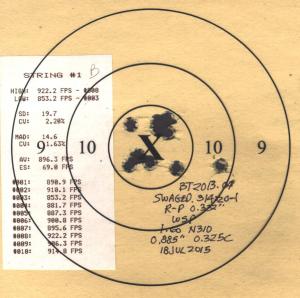

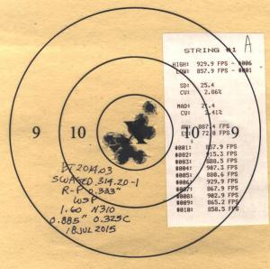

More Ammo Testing...
Greetings All,
I loaded some more of the ammo I tested previously to see if it would repeat. Sadly, it did not. I fired five targets of ten rounds at 50 yards and while they all stayed inside the 10-ring, there were no duplicates of the X-rings groups I previously fired.
Being an experimenter, I applied a taper crimp to 20 of the above cartridges. That is, I loaded 70 rounds total in one sitting and went back and crimped 20 of them. The remaining 50 had no crimp at all.
Attached are the two test targets fired at 50 yards via a mechanical fixture. Again, I will be back at the test facility to see if I can duplicate my results. Oddly, the target marked "culls" shot very well. I think they are "culls" as the bullet moved forward during the crimping operation. Lesson learned? Write things down.
Edit.... Putting away the empty boxes, I noticed that the 50 rounds were sized with a Carbide sizer making the brass 0.334" OD. The remaining 20 rounds I used a sizer to form the brass to 0.333" OD. Now I remember why the bullets were not holding uniform length.
Looking at the chronograph data, the extreme spread showed some improvement. However, remember this is only a ten round sampling. When I test again, I will compare 30 non crimped versus 30 crimped to observe any changes.
With all my 32 ACP testing, I have noticed gas blow back when I fire the cartridge. With jacketed ammo, all this leaves is a sooty residue on the bolt face. The swaged bullets I am testing are lubricated with Lee Liquid Alox. While the barrel shows little Lead fouling, the blow back leaves a sticky residue from the Alox. Something to keep in mind with swaged or cast bullets using soft lube. i.e. more cleaning may be necessary.
- A 0.325" taper crimp applied as measured at the mouth.
- 314.2014.03.0047.jpeg (24.29 KiB) Viewed 6138 times
- These are the bullets marked CULLS.
- 314.2014.03.0048.jpeg (24.95 KiB) Viewed 6138 times

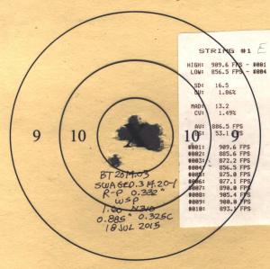

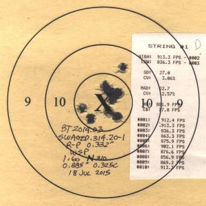

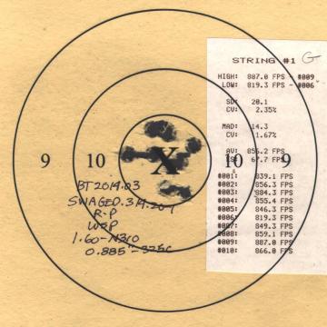

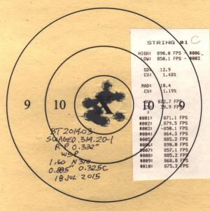

Ammo Testing Went Well Today...
Greetings All,
I tested 50 rounds of 32 ACP Saturday with good results.
Distance is 50 yards
Barrel is a Pardini 32 ACP mounted in a machined fixture.
Bullets are swaged from reject cast bullets lubed with Lee Liquid Alox. Diameter is 0.3143". Alloy is 20:1 (Lead:Tin)
Brass is all R-P, 0.670" long.
Taper crimp is 0.325" measured at the mouth
Overall length is 0.885".
Primers are Winchester Small Pistol (WSP)
Powder is VV N-310
I recently ordered an Accurate Mold #31-065H that will produce 0.314" bullets. When it arrives, I will allocate time to test bullets cast of LinoType and 20:1 alloy.
Powder is VV N-310
- 314.2014.03.0049.jpeg (18.59 KiB) Viewed 6032 times
- 314.2014.03.0050.jpeg (18.33 KiB) Viewed 6032 times
- 314.2014.03.0051.jpeg (18.19 KiB) Viewed 6032 times
- 314.2014.03.0052.jpeg (18.34 KiB) Viewed 6032 times
- 314.2014.03.0053.jpeg (18 KiB) Viewed 6032 times

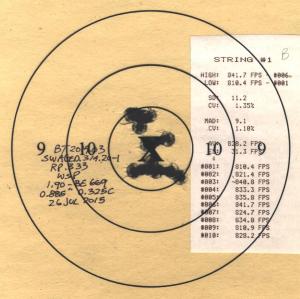

32 ACP with Bullseye Powder

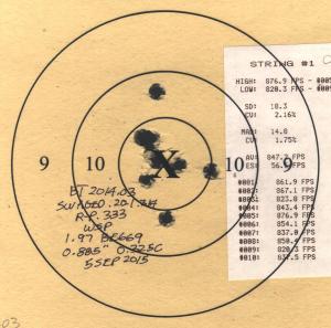

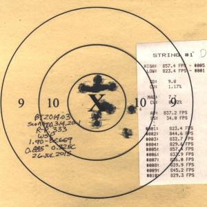

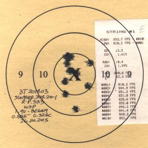

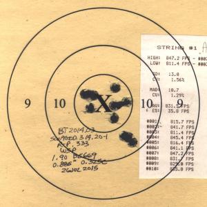

Greetings,
My recent 32 ACP testing session was conducted using Bullseye powder to try and reduce the Extreme Spread and improve the Standard Deviation. So far it looks promising.
The groups were not as good as the 1.60 grain of VV N-310; but, the Average Velocity is lower. When time allows, I may try increasing the Bullseye charge from 1.90 to 2.00 grains to see what happens.
Currently, I am out of bullets and need to start casting again. However, my other machine shop projects are taking precedence.
Testing conditions....
Pardini 32 ACP barrel mounted in a machine fixture.
Distance is 50 yards.
Home swaged 64 grain bullets lubed with Lee Liquid Alox.
Bullet alloy is 20:1 Lead:Tin
Bullet diameter is 0.3143"
Ammunition assembled on a Star Reloading machine.

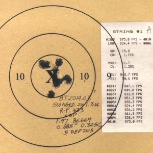

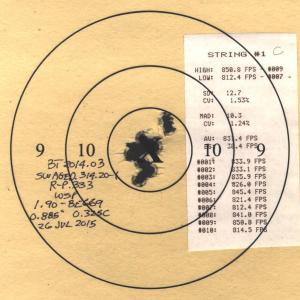

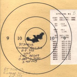

A bit more Bullseye seems to help
Greetings,
My recent test session was to find out if increasing the charge of Bullseye would improve my grouping. The results were good; but, I am not sure the added recoil is worth the effort.
The targets used home swaged bullets, again. What I do is "squash" my reject cast bullets into a more useable shape and so far it works well. A future project is to machine a mould to cast slugs in order to produce a better bullet. Squashing a bullet with an existing grease groove is not the best way.
I did obtain some Hodgdon TiteWad and I will post my best effort in a separate message.

Hmm...very interesting. Why not just leave the brass at the as-fired size so it doesn't end up being sized down, blown up and on and on. If that doesn't work then maybe a custom sizing die is in order, say a few thou larger in diameter.
I'm really struggling to get the T&B bullets to fit into the cases and I need a larger diameter expander which I shall make tonight.
BTW- I'm really impressed with the new micrometer powder die from UniqueTek. That device is really accurate and easy to set up. It took a bit of fiddling to get it to not be too tight but that was expected.
Re: Pardini HP 32, ammo talk
Greetings,
I recently finished a set of custom sizing dies for a fellow 32 ACP shooter. Six dies that increase in size by 0.001".
What he does now is select the die that sizes the case "just right" for the bullet diameter and brand of case.
Actually, I do the same thing myself. For 32 S&W Long WadCutter, I use only Lapua or R-P cases. I select a sizing die to suit the 0.314" or 0.312" bullets I load. My expander plug measures 0.308" and does not touch the inside of the case. It only flares the case.
Why do all this? The less you work the brass the longer it will last.
