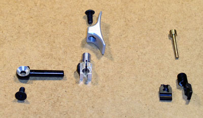

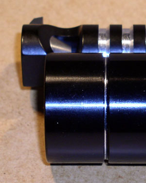

Just for demonstration purpose: The trigger is set to an extreme for lefties. For righties the extreme is less due to a slight asymmetry. The group of trigger parts show in the right the brass pin and cracked thingy, as mentioned in my earlier post. The air cylinder has an indicator in the front, a spring loaded movable cap. In the picture you will notice a shiny ring. Filled to 200 bar two rings will show. When the last ring disappears, the pressure has dropped to about 90 bar and some 30 shots later one has to change the cylinder.
Regards Hans.
