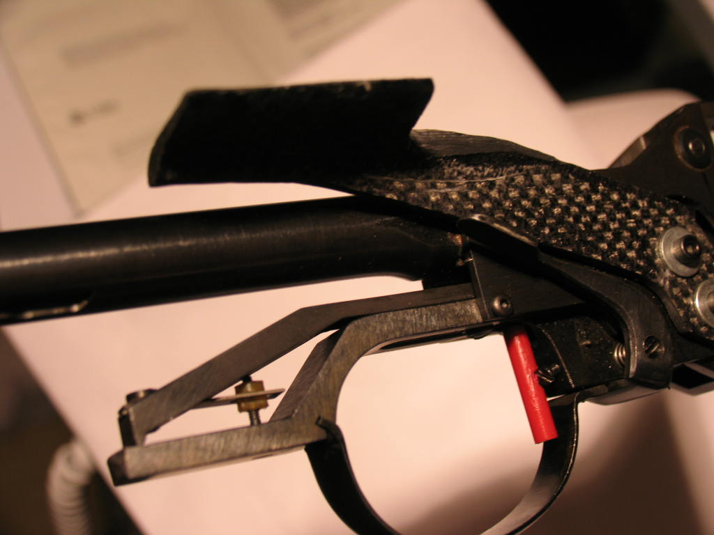

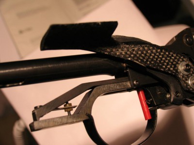

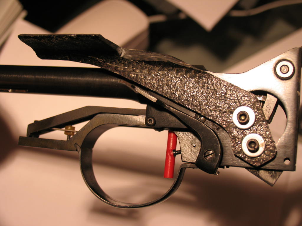

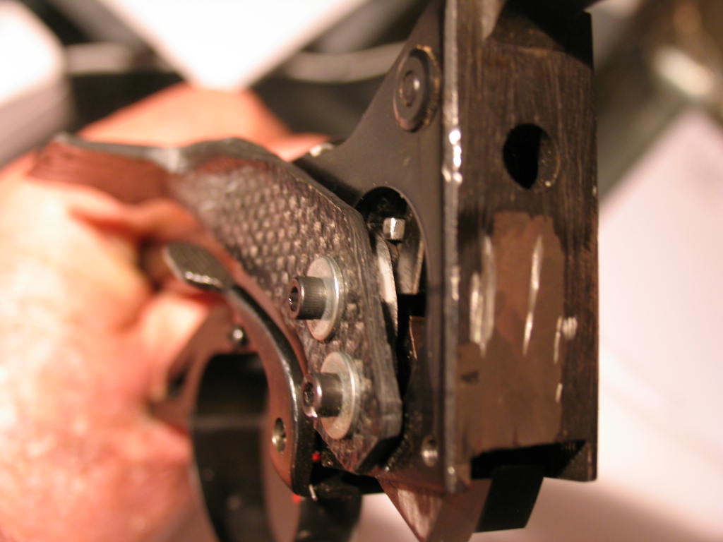

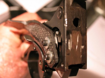

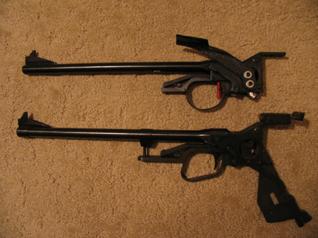

Well ,here is phase one...removal of the original lever system,addition of new lever,modification of front "forend" metal,and a trigger for short-fingered folk ! The carbonfiber lever is obviously in its "rough" configuration. The pics show the adapter/spacer plate to give clearance between the lever and the action body,and also the weight removed as well. And if anyone feels this was an odd thing to do to an otherwise perfectly good pistol ,well that's OK, too. Next is to add a detent ball for the lever,modify the original grip mounting system for a one-piece grip,similar to morini/pardini with angle and rotation adjustment,add more lightness (thankyou ,Colin Chapman...Lotus ),build a fore-end cover incl. adjustable weighting , and hopefully the new sights will be here soon. Until the next time ,dear readers....
before and after...yes,I know that's an M in the pic
spacer
spacer
ORIGINAL WEIGHT WAS 2 lbs,1 oz
