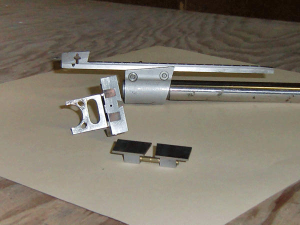

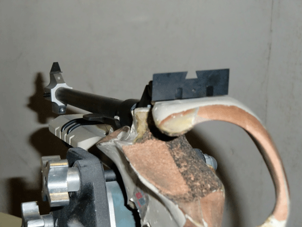

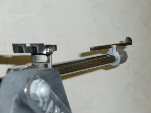

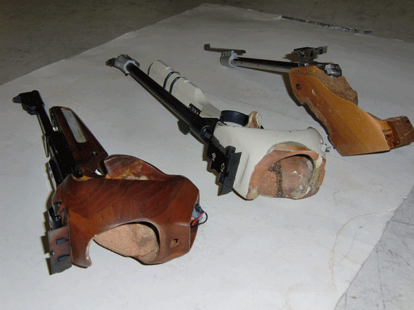

Some triangular sights Paul Ha made in the '80s
Mr. Paul Ha kindly asked me to post these images, of sights he developed in the 80's.
An electronic trigger was also something he definitely enjoyed with his Walther.
I am much obliged to Paul Ha for sharing in this conversation.
Below his comments and his pictures regarding the triangular sights:
"My personal observation is that any system will eventually work to some degree with perseverance(training); even though most would initially show promises. Old timers, like myself, call this the 'new gun syndrome'. Two truncated dissimilar equilateral triangles would post some additional challenges though."

Additional thoughts on truncated triangular sights
First of all, I would like to thank Mr. Paulo Andrade for his time and help in posting the pictures.
The additional challenges I allured to with Mr. Kraft's proposal of using truncated dissimilar equilateral triangles would be for the shooter to acquire equal daylight on both sides of the front sight relative to the rear sight. Truncated similar equilateral triangles do that quite readily, since they provide the longer geometric reference lines resultant of their similar shapes.
Mr. Kraft's reliance of the convergence point of the apexes of two dissimilar triangles would of necessity be replaced by a single apex formed by the extension of the single 'day-lighted' triangle, if one should insist on imaginery point aim. Depending on the width of the preferred daylights, the apex of this single 'day-lighted' triangle would also be less academically precise than that of Mr. Kraft's convergence point.
But perseverence(training) is part of the fun of shooting, and, it would not matter much to one whose total concentration is on one corner of the front sight relative to one on the rear anyway.
Have fun shooting and experimenting.......
