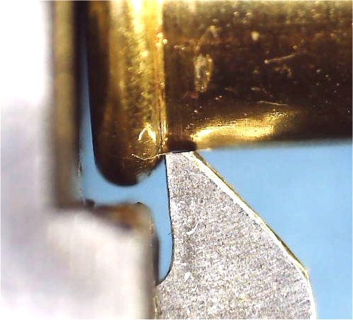

The extractor tip geometry that seems to be required to work well is unlike any pistol extractor setup I've ever seen before. If my theory is right, it works by supporting the case at three locations instead of the usual two (extractor tip & rim pocket on slide face).
It's a bit difficult to explain well without drawings and pictures. The case is still in contact with the slide pocket on the left, but the extractor hits the case wall at the forward edge of the blunt tip in the photos.
4-1-22 Extr #2 +1 deg w Case (Clamped).jpg (45.42 KiB) Viewed 8146 times
That tips the case to the left, and the extractor slides down the case wall until the rim of the case hits the back of the extractor tip.
4-1-22 Extr #2 +1 deg w Case (Unclamped).jpg (45.07 KiB) Viewed 8146 times
The case is now held at three locations, but I think the key thing is that the contact at the back of the tip is a line and not just a point. The edge of the extractor is in contact with the front of the rim, which is (vaguely) flat. When the case is held this way, you can actually feel resistance to the mouth of the case tipping downward.
If your extractor is marginal in an MG2, you will typically experience jams after the 5th round. I think this is because there's nothing in the carrier to prevent the case mouth from sagging downward. That bounces off the slide rail, knocking the case loose prematurely.
The piece I haven't figured out is why nobody else's pistols require this 3-point support. It may have to do with the really fast cycling with the light slide. If the pistol pops up really fast in recoil, inertia will tend to hold the case mouth down.
In any event, those are my current theories... The extractor in the above photos shoots Aguila just fine now, and in several hundred rounds, hasn't bounced a case off the slide rail once.

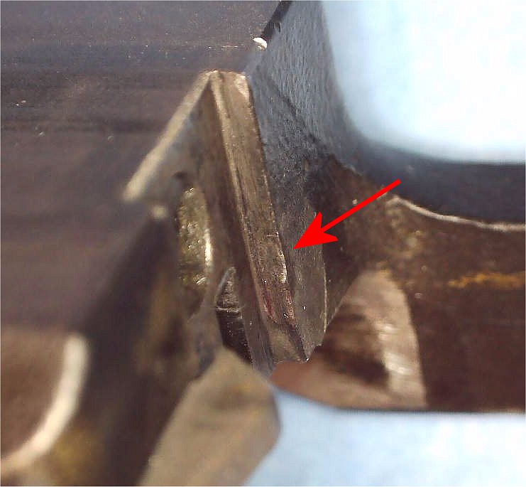

3) Improve the longevity of the design. For example, the extractor has such a death grip on the cases that the cartridge rims are wearing a groove in the left side of my slide. I think that is why my first extractor stopped working. The groove got deep enough the extractor couldn't swing far enough to keep a reliable grip on all cases:
1088 Case Wear from Extractor Force.jpg (52.89 KiB) Viewed 8124 times
It's easy enough to stone down the extractor so it can swing in further, but at some point, that's not going to do it. I can at least slow down the wear with a weaker extractor spring, but I need to get the geometry figured out first.

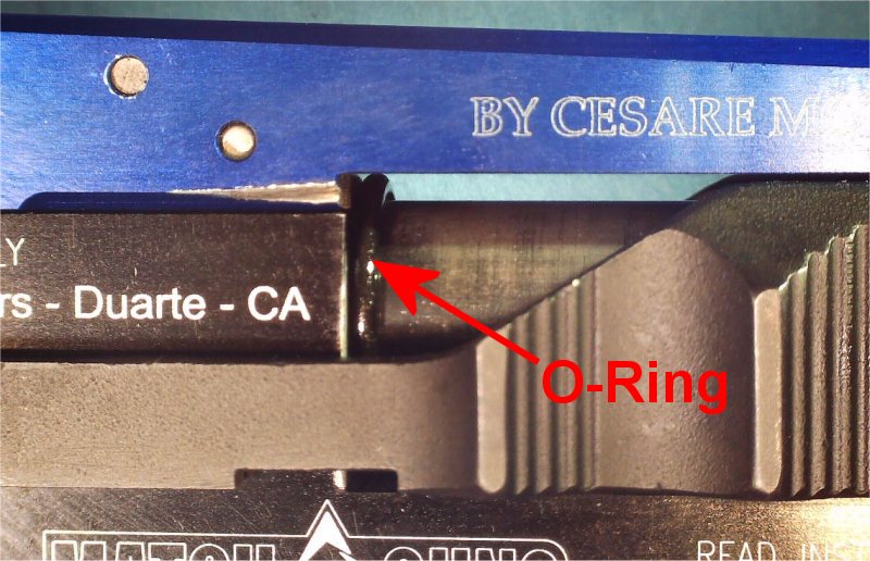

One issue that may come up if you add weights is cracked slides. The EVO's around the S/N 1050 - 1100 range had slides that tended to crack at the thin spot above the barrel hole. The original MG2's had a buffer in front of the center part of the frame where the barrel goes through, but they decided they weren't necessary. Kang Chua suggested using an O-ring, and I found one that would work as a buffer.
https://www.mcmaster.com/9558K21/
I installed one after many thousands of rounds, but my slide eventually cracked anyway. I installed one on my wife's pistol (1 serial number different), which hadn't been fired nearly as much, and her slide is still fine. I believe Kang is installing them in all the new EVO's. If you don't have one, they are cheap insurance.

I have a MG2 EVO RF with a serial number in the questionable area mentioned above (1050-1100). It had no slide buffer when I got it. I notice a slight amount of peening on the frame where the slide hit it when going back. I tried the O-ring but had occasional problems. Then installed the buffer used for both the MG2 and the MG4. After several thousand rounds, I have had no problems at all regarding operation. I have recently passed the 10,000-round mark.
I did find that I could no longer lock the slide back with the buffer installed. I later found out that the reason that the EVO RF did not come with the buffer installed at the factory was because the frame lacked the necessary clearance and the solution determined at the factory was to modify the EVO RF frame. The factory decided not to do that.
I have since reduced the thickness of the buffer enough to allow me to now be able to lock the slide back. That, given what I have written above in the above paragraph, has fixed my lock back issue. With or without the buffer installed, I could still insert an Empty Chamber Indicator necessary for Bullseye/Precision Pistol matches.
With the modified buffer now installed, I have solved the lock back issue while also providing a necessary and ample cushion between the slide and frame.
Posts: 3561
Re: Mg2
I must say that I'm confused by reports of trouble using the O-ring buffer. I have three Evo's that all work fine with them, and I've set up two others that (as far as I know) haven't had any issues.
Very strange...
