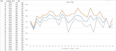

I went through the scores of a high level shooter who's been shooting for at least the last 26 years, from age 32 to 58, and here's the data I managed to collect from ISSF records.
I tracked a total of 100 results across this shooter's career specifically in the 10m Air Pistol Men event, and only tracked qualification scores.
I'm not the most proficient at data analytics, but my observations are:
1. There was a clear incline in scores from age 33 to about 39, after which scores remained steadily between about 575 and 580 between 40 to 50.
2. Shooter "peaked" at around the ages between 47 and 51, where he hit his highest score ever (587) and average score was still in the 580 range.
3. There seems to be a decline in average score starting from 51 to 58, but data collected in the last 4 years have a relatively small sample size.
Feel free to add in your observations!

Interesting! Thank you for spending time doing that.

No worries! I was interested to find out too, just to get an idea of how much longer a runway I would have personally too. Hope the data helps!

Thanks! I’m going to find a more efficient way to parse the data on ISSF and hopefully come back with a bigger sample size with more shooters!
