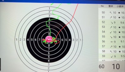

How to obtain such a curve in air rifle 10m??

Last night, I slightly twist my hips towards to the bull, and get a trace like this.
it's funny. It's get a less swing and more steadier.
10.9

Very nice result. Well done.
