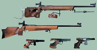

Sorry for the delay... I tried to find the source where I think I once read something about this pistol, but can't find it. If my memory serves right, the .22 Alifirenko is shooting now was basically a trial version for a downsized center fire pistol. I think somebody told me that some east bloc shooters were using the MTS440 for CISM MRF, but the .22 was pretty much unknown until Alifirenko (is he the only one? At least the Ukrainians don't seem to use it...) started shooting it for RFP. And I haven't the slightest clue about where it came from or who the designer was (KBP?!). I have a scan of an absolutely outstanding russian book from 1981, and it's not mentioned in there (contrary to the Khaidurov pistols, so it may not only be because of state secrets). It may have derived from the MC57-1 design (which was an RFP, see bottom row/left on the pic), though. It's interesting that the company claims to export the things, one should try to get one... Does anybody know if this 7.62 is the Nagant ammo or .32 S&W?
- Strange russian target pistols.jpg (9.08 KiB) Viewed 2666 times
