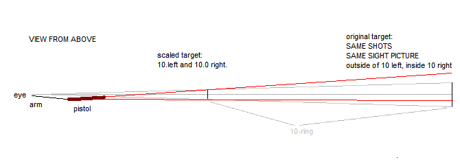

Excuse me if I'm showing myself to be out of my depth, but in this diagram, while the targets are in line with the line of sight, the pistol is engaging the targets on an angle, effectively positioning them out of line, with respect to the pistol. What is this proving?
Paul
AAlex
Posts: 113
Joined: Wed Dec 06, 2006 8:06 pm
Post by AAlex »
It is proving that when the rear sight is not aligned exactly to the target due to wobble, your cone analogy does not work.
pgfaini
Posts: 328
Joined: Sun Oct 24, 2004 2:34 pm
Location: North Carolina
Post by pgfaini »
AAlex wrote:It is proving that when the rear sight is not aligned exactly to the target due to wobble, your cone analogy does not work.
Of course it works. The two shots are diverging at the same angle all the way from the gun to the original target. The two shots would still span the same relative scoring values on both targets, if they were sized proportionaly,(which we now find they aren't). What does mis-aligning them prove? The diagram has no quantitative value, you could draw it so that the rear target was missed by fifty feet. What would that prove? I thought we were discussing whether there were scoring errors caused by the variations in bullet diameter relative to target size. That was my laser analagy regarding the line of flight of the bullet's inner edge, disproving that as the bullet's relative size(diameter) increased, it would score higher, on proportionaly sized targets.

Posts: 113
Post by AAlex »
That was not part of the discussion until someone had the ingenuity to proclaim the targets scale proportionally, even though it was mentioned indirectly that it wasn't so in the first few posts:
This target is scaled incorrectly - at 5m diameter of the inner ten ring should be 0.25mm, and 10 ring should be 3.5mm.
Shooting at lower distances, even with the target black and scoring rings appropriately scaled down, accounting for the projectile diameter, etc.
Then the thread switched to the discussion of whether and why the wobble matters more on shorter distances, although the only "rebuttal" was some people bashing the straw man of their own definition of "parallel error".
