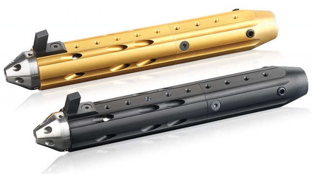

It looks really cool but i decided not to get it because of the weight. the new compensator already adds around 100 grams
Muffo
nvalcik
RE: Toz 35 Modifications
Post by nvalcik »
The aluminum forend basically gives the user the ability to add weights to balance the pistol to their liking and it does feel a tad lighter than the wood forend that is on the TOZ. If I end up getting the comp from Eurosport I am probably going to have a barrel made that is lighter and shorter to adjust for the length of the compensator since I like the existing sight radius. A friend of mine (who visits this forum) also notched out a wider back sight opening and made a extra wide front sight which I have found to be very advantageous in the last match that I shot. With a new barrel and compensator I may want to add weight somewhere in the forend which the new forend would allow me to do. I thought it made the pistol look more modern as well, but that had nothing to do with my decision to buy one and try it.

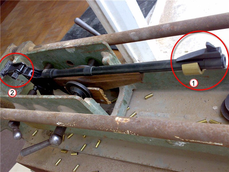

that is the first post to me so i have many questions to all of you.
in my TOZ-35 with Morini grip ....how can i remove the front site to use the new Compensator (circle 1) & what i can do with the adjustable part ( circle 2 ) couse the wight of front it will be different ??? bigger than a hole in the adjustable part ( circle 2 ).... any suggest ?!!!
[/img]
the new Compensator.
toz-35
toz-35
Chris
Posts: 381
Location: OR
Post by Chris »
Lucky for you that is a Toz35m. If you remove the front sight blade there is a screw underneath it. Remove the screw and that front site housing will slide off.
If you have some spare rear sight blades you can use a wider one....or you can make a new one. should only need some flat stock...drill and tap 2 holes and then cut your self a notch as wide as you want. You could also modify the one one you have and make it wider.

Chris wrote: If you remove the front sight blade there is a screw underneath it. Remove the screw and that front site housing will slide off.
Pretty sure that there is only one small screw holding front sight blade. Front sight housing sticks very tightly and I suspect that it's put by warming up the housing ring prior to putting onto barrel.
" chris" is correct..there is a small vertically oriented screw underneath the removeable front sight blade.
imbecile
Posts: 16
Joined: Tue Oct 28, 2008 9:48 am
Post by imbecile »
So there is difference in front sight compartment between Toz35 and Toz35M. Thanks, I didn't know this.

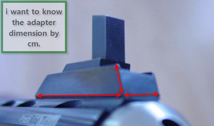

sha3banov
Posts: 26
Joined: Sun Mar 29, 2009 4:18 pm
Location: Egypt
Post by sha3banov »
imbecile wrote:
i have with me friend a Compensator for morini (the original one ) can i use it in my pistol....[/quote]
Yes you can, but don't forget to apply adapter
http://www.euroshooting.eu/en/foto2.php ... ompensator
because TOZ 35 has higher sighting line from barrel axis comparing to CM84E.[/quote]
woow it is like a weapon from other planet :)
ican made it but i want to know the adapter dimension by cm.
