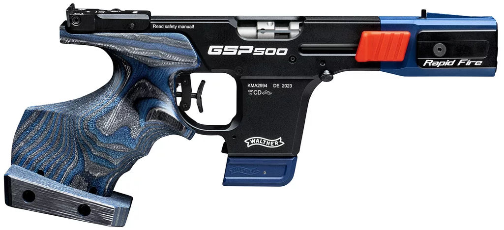

new GSP500 Rapid Fire variant announced:
https://carl-walther.com/sport/products/p/2877848M

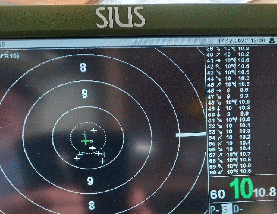

Ammo Testing
Chronograph Results - 15 round sample, Fastest to Slowest
Brand Average Extreme Spread Std Deviation
Geco Semi Auto 294 m/s 17.3 m/s 16.2 m/s
CCI Std Velocity 284.3 m/s 15.9 m/s 13.5 m/s
RWS Target Pistol 269.6 m/s 26.1 m/s 23.0 m/s
SK Std Plus 257.5 m/s 36.5 m/s 26.1 m/s
SK Pistol Match 251.0 m/s 28.3 m/s 26.5 m/s
Chrono results show 6-7 m/s faster for same ammo than Pardini (SK Std+ now safely passed)

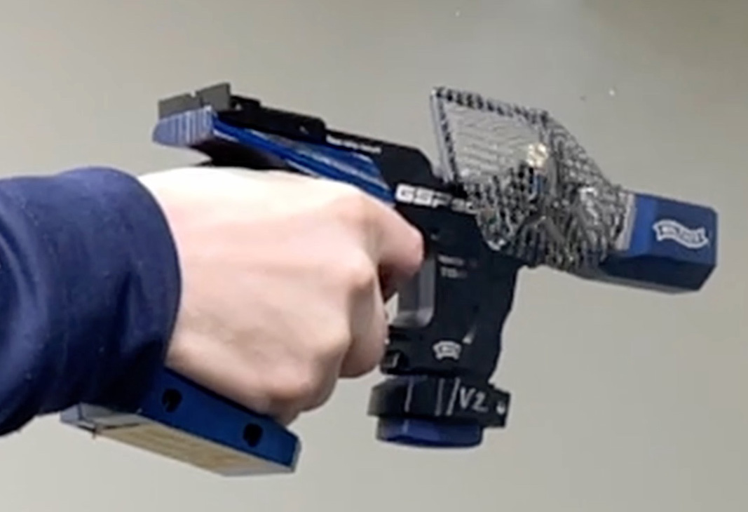

Jeff-France
Posts: 17
Joined: Thu Mar 26, 2020 7:54 am
Re: GSP500
Post by Jeff-France »
Hi, some news of the catcher.
After many months on research and tests (7 prototypes), the catcher is ready (see video) with only one restriction, the standard cartridges like Lapua have a charge that is too powerful and are ejected hazardly.
The majority of shooters use a load between 0.09 and 0.08 grams of BA10 powder for reloading. It is with these parameters that we got the results of the video.
https://youtu.be/6WCfp-5kSgU
