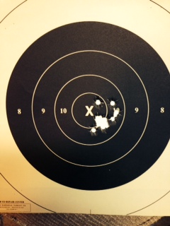

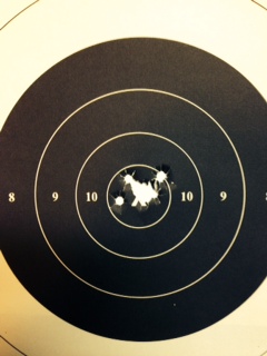

These are two 10 shot targets shot at 50 yards with Old Casters's bullet.
- 50 yd 32 acp pmc brass.JPG (33.84 KiB) Viewed 8332 times
- 50 yd 32 acp winchester brass.JPG (32.02 KiB) Viewed 8332 times
Re: Pardini HP 32, ammo talk
Now those targets have really caught my attention! This is the Tight wad load?

Those groups are from the info I submitted prior with TiteWad.

From a rest, I presume?pistol champ wrote:These are two 10 shot targets shot at 50 yards with Old Casters's bullet.
- Posts: 132
- Joined: Thu Dec 25, 2008 4:35 pm
- Location: Eastern PA
Yes from a rest. I'm a high master but I'm not that good.

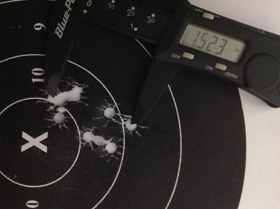

I shot Pistol Champ's combo today except with 1.6 of Vv N310. Off the bench with a red dot only, 8 of the 10 rounds were in the X, two out in the 10 ring. Did this twice in a row. They were all good trigger pulls. Not sure why the two drifters, but still awesome groups. I suspect my crimp was a bit loose so I will add a bit to that and retest hopefully tomorrow.
Please, anyone, chime in about the lube. Can I clean that off or leave it alone. This is all new to me.

I do not have access to a ransom rest, so I use a bench rest with my Aimpoint 4 MOA red dot. I know it's a good hold because I can duplicate ethe results. Today I ran some Old Caster designed bullets again that I casted. Similar specs to what Pistol Champ posted in regards to the loading. Mine were 0.870 oal, 0.333 crimp, with 1.7 on VV N310. Didn't set up the Chrono either. But I shot almost 100 rounds. Largest group was about 2 1/2" (again, off the bench) with usually 8 out of 10 under 1.5". The last two groups were under 1.6" and the 5 shot strings were grouping together so I would bet a paycheck out of a ransom rest these would be closer to 1" groups.
My bullets drop close to 0.316 from the mold. I size them to 0.3148". Alox lube. Once fired Hornady brass.
