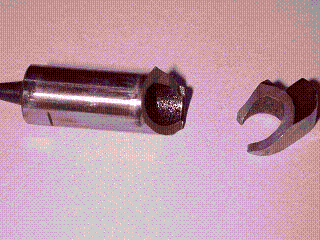

The firing pin on the free pistol is a heavy tapered pin which can be safely fired "dry" with the breech closed with no damage to pin or barrel.
However do not activate the trigger with the loading lever up or partly up as you will snap the lug off the side of the firing pin eventually.
- note the taper on the front of the pin.
- Broken Firing Pin.GIF (18.86 KiB) Viewed 5509 times

What you say is true. And I have broken firing pins (resulting in peening of chamber face) on a match-grade Hi-Standard and a plain old Ruger pistol. Both are designed as you describe- and both firing pins broke at the shoulder where they are designed to stop forward movement with no case in the chamber. Sigh. When it happened on my Ruger, I didn't care much . . . but when it happened on the $$$ Hi-Standard, I began using snap caps. Both instances resulted from what the factory people said was "excessive" dry firing and therefore not covered under warranty. Even though the owner's manuals said dry firing was o.k. Excessive was about 50 snaps a day over about a year or so . . .

After talking to Francesco about this he told me they rarely see broken firing pins. The pic that Davide Moore so kindly posted highlights the most common cause of breakage - dropping the firing pin with the breech not fully closed. Francesco's recommendation to me was to always use an empty cartridge case. So far it has worked well for me! (Of course, my little box of goodies that sits on the shooting bench carries a spare firing pin and spring, as well as a complete spare breech block, just in case!).
