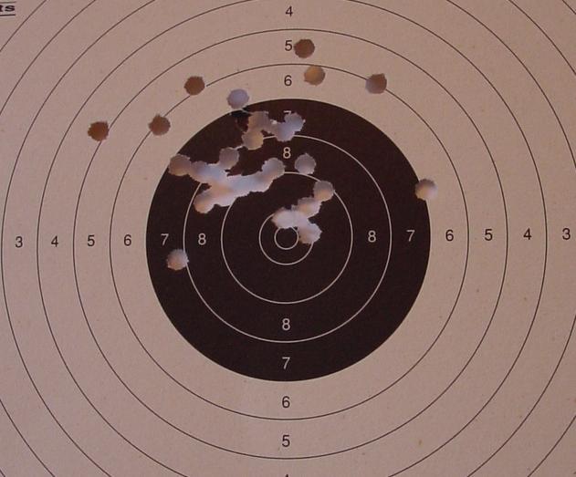

Hey Steve Or Bob
I shot 30 shots at this target as Steve recommended.Shows alot more than a 10 shot target.Steve or Bob how would you adjust your sights for this target shooting?Ron
- 30 shots
- target2.JPG (38.86 KiB) Viewed 2891 times
Down 4, Right 1.
Then shoot another 30-shot target.
Rought cut "Center of Mass" is to visually kind of exclude any really wide shots and focus on where the bulk/majority of shots are falling. Adjust sights to center that portion of shots.
Next step *after* super-gluing sight setting is to begin to get comfortable "calling" your shots. During/after follow through, picture in your mind exactly where you thought the shot fell. Mark it on a diagram. Then, check where the shot actually fell.
After you get good at calling your shots, sight adjustment process is a little more subtle. Shoot- and call- ten or more shots. Then look at difference between where shost fell and your calls. Is there a pattern? Let's say 8 out of ten of your "calls" were higher than actual. Adjust your sights up. 7 out of ten are to the right? Adjust your sights to the right.
Adjust your sights so that the shots fall close to your call. Of course, if you aren't skilled at calling your shots, this will actually make "chasing your sights" even worse! It's very important to do the "shoot 30/set it and forget it" first, and develop yiouir skill at calling your shots *before* trying to make any sight corrections based on your shot calls!
WHEN SHOTS DON"T FALL WHERE THEY ARE SUPPOSED TO, IT ISN"T YOUR SIGHTS THAT NEED ADJUSTMENT!
Good shooting by the way! Concentrate on keeping front sight in focus, keep sights aligned, accept your settle, and releasing the shot subconsciously.
Steve Swartz

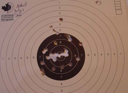

adjust 1
Steve before you got back I made two ajustments. This target was shot 30 after 5 clicks left and 5 clicks high. Steyr settings backwards. See next target.
- 30 shots 1st adjustment
- target3.JPG (17.96 KiB) Viewed 2878 times

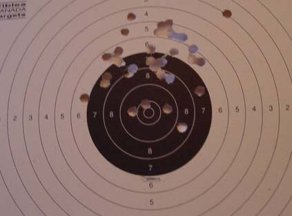

2nd adjustment
After the last target I made adjustment 2. Gave it 10 clicks H only, we shot this target. Should I stop at this setting and practice? Ron
- 2nd adjustment shot 30
- target4.JPG (22.07 KiB) Viewed 2875 times

Re: 2nd adjustment
Yes, unless you're in a match and need to maximise your score.darticus wrote:Should I stop at this setting and practice?
Also, make sure your shooting kit includes a clear diagram telling you which way to turn the sight screws to move the shots in the direction you want. Adjusting the sights the wrong way in a match is unforgivable.
A useful crib note is the number of clicks to take the sights from their lowest physical level to your approximate shooting zero. This is handy if you shoot more than one distance/diagram with the same pistol, it is also a useful precaution to take the sights down to prevent springs/ball bearings from becoming unseated during flight.
I like to put a couple of sticks on the gun recording the direction, changes and from zero point; I say two as equipment control could cover over one of the sticker!
Enjoy your shooting!

Regarding your last target... You look pretty darn consistent, barring those couple high flyers. Are you spotting after each shot and noting what you did for those?
When starting out - Once I had my ducks in a row with regard to natural point of aim, sight/target focus, breathing, grip, and trigger control, I was clustering mine as best as my "wobble zone" would permit. Any stray shots and I'd just go back to the above-mentioned basics. Always a result of a breakdwn somewhere amongst them as to why a shot went bad.
If you haven't already read.... The Bullseye Pistol site's Army Marksmanhip training guide is a Bible of the basics. Once you have that down you can just use the "shot wheel", a clock-type reference picture (probably can find with a search here) for diagnosing what you're doing wrong - 9 o' clock: too much/too little finger on trigger, etc...
Sorry for rambling. Perhaps you've already done all of the above. Regardless, good luck!

top shots
I was shooting too high on the last target so I had to set sights to lower the hit but I turned the adjustment toward lower instead of higher for Steyr.They wouldn't be there if I wasn't sleeping.Thanks gotta check out that book you said.
Thanks Guys great info!
Worked with my LP 1 today and set up my LP 10.Now I can practice and hope to improve.I guess I can make further adjustments in the sights as needed in checking and compareing many targets. I think I gotta get my arms and fingers to cooperate first. Ron

I find it useful to translate from mm/click to clicks/scoring ring since, when you're looking at your target through a scope (or even if you bring back to examine) it's a lot more convenient to estimate how many rings you're off than it is to pull out a ruler and measure mm. For example, I have a Steyr LP-10P for which one click (horizontally or vertically) = 1.2 mm at 10m (same as for the LP-1.) Since a scoring ring is 8 mm, this means it takes 8/1.2 = 6-2/3 clicks/ring to move the group.
So here's the little cheat-sheet I keep with my Steyr:
One ring = 6-2/3 clicks
H moves down
T moves up
R moves left
L moves right
In the original example, target2.jpg, and assuming this target was consistent with others you'd shot, I'd have estimated you were about 2.5 rings high (or a little less if you discard outliers) and one ring left, meaning I'd have adjusted the sights to move the group down 17 clicks and right 6 clicks.
H moves down
T moves up
R moves left
L moves right
