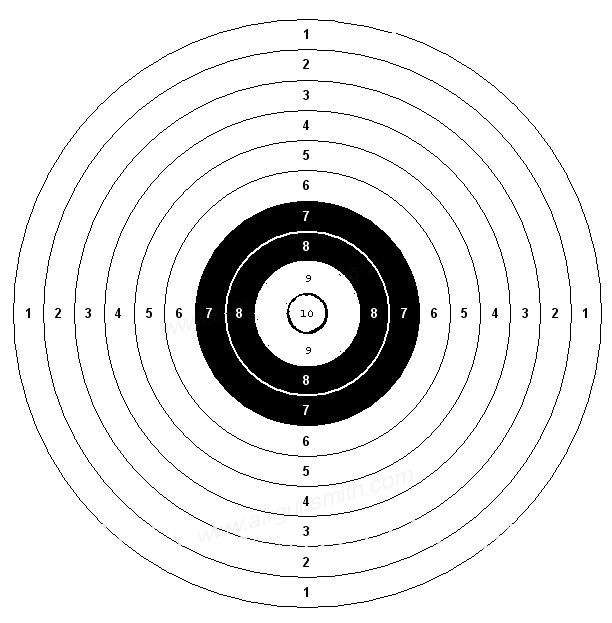

10 and 9 ring removal practice
Would it be the same to just make the 10 and 9 ring white on a computer program and than print for practice?See pic!
- NEW 10_meter_airpistol2cropped.gif (14.86 KiB) Viewed 6083 times
What would that accomplish? You would still see the holes/score.
Besides, the diameter of the 9 ring would have to be increased 9 mm (4.5*2), since shots tangent to the 9 ring count as 9's

Re: 10 and 9 ring removal practice
Sorry Fred, I didn't understand you were not to see the hit holes.I thought it was just to put everything in the 9 or 10 ring. If you didn't see the hit, because it was cut out, you know you hit anyway, but not exactly where you hit.Guess I got it wrong.Fred Mannis wrote:What would that accomplish? You would still see the holes/score.
- Fred Mannis
Exactly. You want to reward your subconscious for keeping all the shots inside the xx ring, not for the score. Eliminates the frustration (bad feedback) of keeping all shots inside the xx ring, but no 10's!darticus wrote:... you know you hit anyway, but not exactly where you hit.
