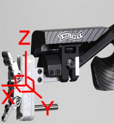

The vertical and horizontal axis of rotation are defined in conventional terms, with respect to a reference plane. In the case of rifle shooting the horizontal plane of reference is the floor (and all planes parallel to it). IOW, the horizontal axis of rotation for the buttplate is parallel to the bore axis and the vertical axis is normal (perpendicular) to the bore axis.

- A visual might help

Butt plate rotations
There's 3 perpendicular axes about which the plate can be rotated.
In my picture (see attachment):
x is horizontal, parallel to the bore.
z is vertical.
y is horizontal, perpendicular to x and z.
So both x and y are in the horizontal plane. The rule saying "Turning the butt plate on the horizontal axis is not permitted" does not have a definition explaining what is meant with 'the horizontal axis'.
In my understanding, the rule does not allow rotating around x.
Rotating around z is allowed for sure (as in Jose Rossy's picture).
And rotating around y is OK as well.
Some air rifles (FWB, Hammerli, and probably others too) allow you to rotate around the y axis, although the physical axis of rotation is further forward than in my picture.
z is vertical.
