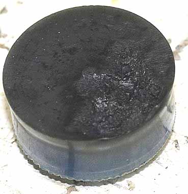

Dieseling by it's very definition, can only occur at one point, i.e., the point of compression great enough to cause the flammable objects to self ignite. Here is a piston face from a FWB SSP that we took apart yesterday, that show some serious "cratering" from dieseling. With normal usage, the entire face will stay blue just like you can see on the bottom of the piston.
Fred
Post by Fred »
Thanks for the picture. I assume this happens at the final moment of the compression charging stroke? When this occurs, is there a burning smell, like there is when a spring-piston gun diesels? In other words, is there any clear indication that this is happening?
FredB
Richard H
Posts: 2654
Location: Guelph, Ontario
Post by Richard H »
Fred wrote:Thanks for the picture. I assume this happens at the final moment of the compression charging stroke? When this occurs, is there a burning smell, like there is when a spring-piston gun diesels? In other words, is there any clear indication that this is happening?
FredB
Actually it can happen anywhere in the compression stroke and it is a small explosion, like a diesel engine, hence the term dieseling. I'm sure you'd know it happened.
