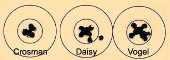

The point of my test was to see how these pellets would do in my nearly new (less than 500 pellets through it) Steyr LP5. However, I started things off by testing them in my Morini 162EI. Here are the 10-shot groups, fired right to left.
You can see why I'm very happy with that Vogel pellet and why I have no intention of going away from it. But, I was a little surprised at how well the Crosman performed.

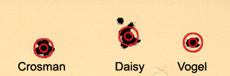

Then, I fired the test groups through the LP5, again right to left. Shockingly enough, the Crosman pellet performed best in my LP5.
A couple of notes. The Morini groups have the normal 10m AP 10 ring and center ten ring graphically shown over the groups. The LP5 groups have the 25m RF target 10 ring and 9 ring, appropriately reduced for 10 meters, shown over those groups.

1. I love the Vogel pellet in my Morini AP and will make no change there.
2. I'm very happy to find a low cost alternative for the LP5, the Crosman.
3. There would be nothing wrong with using the Crosman in the Morini, for practice, as it still easily holds the 10 ring. The Vogel is better though as it groups just about the center 10 ring.
