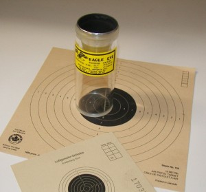

I don't see why an Eagle Eye doesn't qualify as a "flat transparent material" gauge. What it does, is replace the flat plastic gauge and loupe or thread counter which was generally used with it, to better examine the target, with a one piece unit.
For those of you not familiar with the Eagle Eye, visualize a clear plastic pill bottle, with a circle of the proper diameter engraved on the bottom, and a magnifying lens attached to the top where the cap would go. It is layed on the target, over the bullet hole, and peering throught the magnifyer, the position is determined.

I am the manufacturer of the "Eagle-Eye" scoring gauges......for those not familiar, they are a magnifying scoring gauge which allows for the scoring of the target without plugging the shot hole. They are especially useful for the scoring of postal match targets or competition targets where the shooter is not allowed to plug. The target can be scored without disturbing the hole. This is the only way to score targets with multiple shot holes which are clustered together. Targets can be checked right on the range by the shooter before it is officially scored. They are commonly used at ISSF matches, not for final scoring but used by the scoring staff to determine if the shothole is close enough to be plugged by the jury. This saves a lot of wasted time by the jury plugging targets that really dont need to be. There are a number of suppliers in the USA and we sell them through Intershoot in the UK. We can also supply them directly.
Ray.
