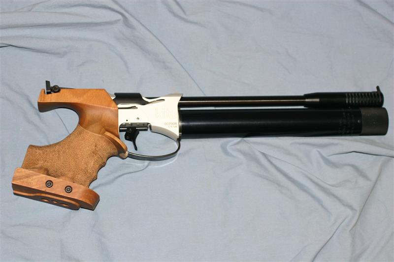

Benelli Kite feedback...
I recently added a Benelli Kite to my group of match pistols. I am quite pleased with it in all aspects. Trigger is excellent and easily adjustable. Balance is good and the pistol is fairly light (a plus or a minus depending on your preference), I have not checked thoroughly into whether there are specific weights available for it. The Nils grips are superb, I find them more to my liking than the Morini grips I have on several other air pistols. In my opinion it also qualifies as an excellent value. It does come with only one cylinder but that is not really a problem. I have already shot some excellent targets with it and would give it a hearty recommendation. Of course if you could only get to play a bit with both I am sure you would find it a lot easier to choose between these two excellent match pistols. My buddy Craig very much liked his Pardini K2S which he only recently replaced as his main shooter with the new FWB P44. Good luck and enjoy, Joe G.

Re: Benelli Kite feedback...
Not only are weights available but, from memory, there are also 4 different length cylinders.JoeG wrote:Balance is good and the pistol is fairly light (a plus or a minus depending on your preference), I have not checked thoroughly into whether there are specific weights available for it.
That should even the keenest "fiddler" enough choice of overall weight/balance. ;-)

Kite trigger....
Sorry you did not like the Kite trigger on the two you sampled. Mine is second hand with probably about a year's time with the original owner. I was not overly impressed with the trigger as it was adjusted by him. A wee bit of adjusting to suit my preference made all the difference. Of my match air pistols the triggers on my Steyr LP-1, SAM K11 and Morini 162e electronic are my favorites. I find the Kite as adjusted is definitely in the same league and preferable to my Feinwerkbaus. I generally adjust the triggers to have a fairly short first stage with a good percentage of the weight taken up there and then a fairly smooth rollover into and through the second stage. As a rule I do tend to twiddle and tweak the triggers on all my match pistols to find what combo seems to work best for me. It also adds to the fun in my opinion. Best regards, Joe G.
PS... in regard to size
Without doing any detailed measurements I would not consider the Kite to be any "bigger" than most modern match pistols, ie, Steyr, Morini, Pardini, FWB, Walther, Hammerli. These and it would be bigger than some of the CO2 match pistols of the not too distant pass and some of the more unique ssp guns like the FAS, Air Match and Pardini P10. Joe G.
Kite, big or small?
The two guns I fired had a HUGE cylinder. Postulated to hold enough air to fire quite a lot of shots, several hundreds (!)?) Many more than any other AP I have tested.

As I said in an earlier post, there are 4 different cylinder sizes for the Kite.789 wrote:The two guns I fired had a HUGE cylinder. Postulated to hold enough air to fire quite a lot of shots, several hundreds (!)?) Many more than any other AP I have tested.

My Benelli Kite was also a year old when I purchased it but, in every way, is as new. From what he has said to me, and in this forum, the former owner probably put 7,000+ pellets through the pistol, but it would be impossible to tell that from the way it performs
The fit and finish of this Benelli, like other Benelli guns I have owned, is everything one could desire in a world class pistol, and it is, IMHO, worth twice the price. I particularly like the complete adjustability of the trigger, and that the guard fits my forward, "finger-tip" let-off style, unlike the LP-10, which I have also shot. I also like the easy dry-fire selector on the side of the gun, the crisp, no-creep trigger response, and, of course the Kite's incredible accuracy.
The loading gate is ambi-dexterous, and it's easier for me to drop a pellet into the trough than to insert one into the receiver, as I had to do with the LP-10 or the Izzy.
After buying my Kite, I bought another cylinder in blue, and it was also less than half the price other manufacturers are demanding. There are pockets for two spare cylinders, tools, and a hidden pull-down area for targets and your range mat in the lovely, fitted, ultra-modern locking hard case.
