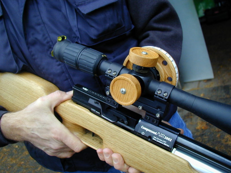

The Anschutz 2002CA fits within NRA Silhouette rules easily as do any of the common 10 meter target rifles. I am also considering the used Anschutz 2002CA route but the trouble is finding one with an offset or (?)shortened loading lever to prevent the lever from hitting the scope, rings, or windage target turret. Does anyone know how much the cost would be to change out the loading lever and if the parts to do this are readily available for the 2002CA?

Anschutz used to make model 2020 & 2025, specifically high powered airrifles. (15 - 20 joule). The loading lever was changed for use with a scope. Some time ago I found attached picture on the net, probably a Dutch Field Target forum. From memory the lever would cost some 80 Euro, interchangability unknown.
