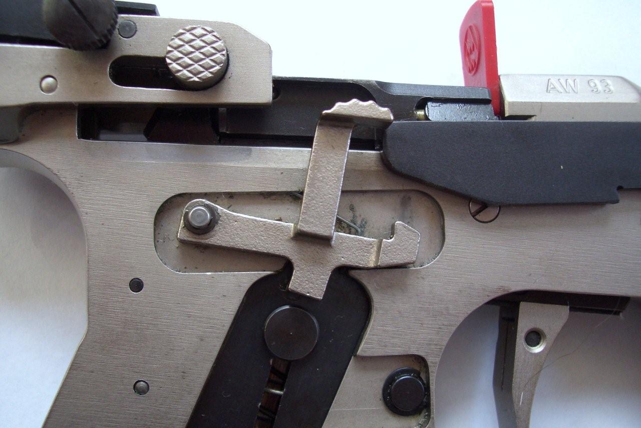

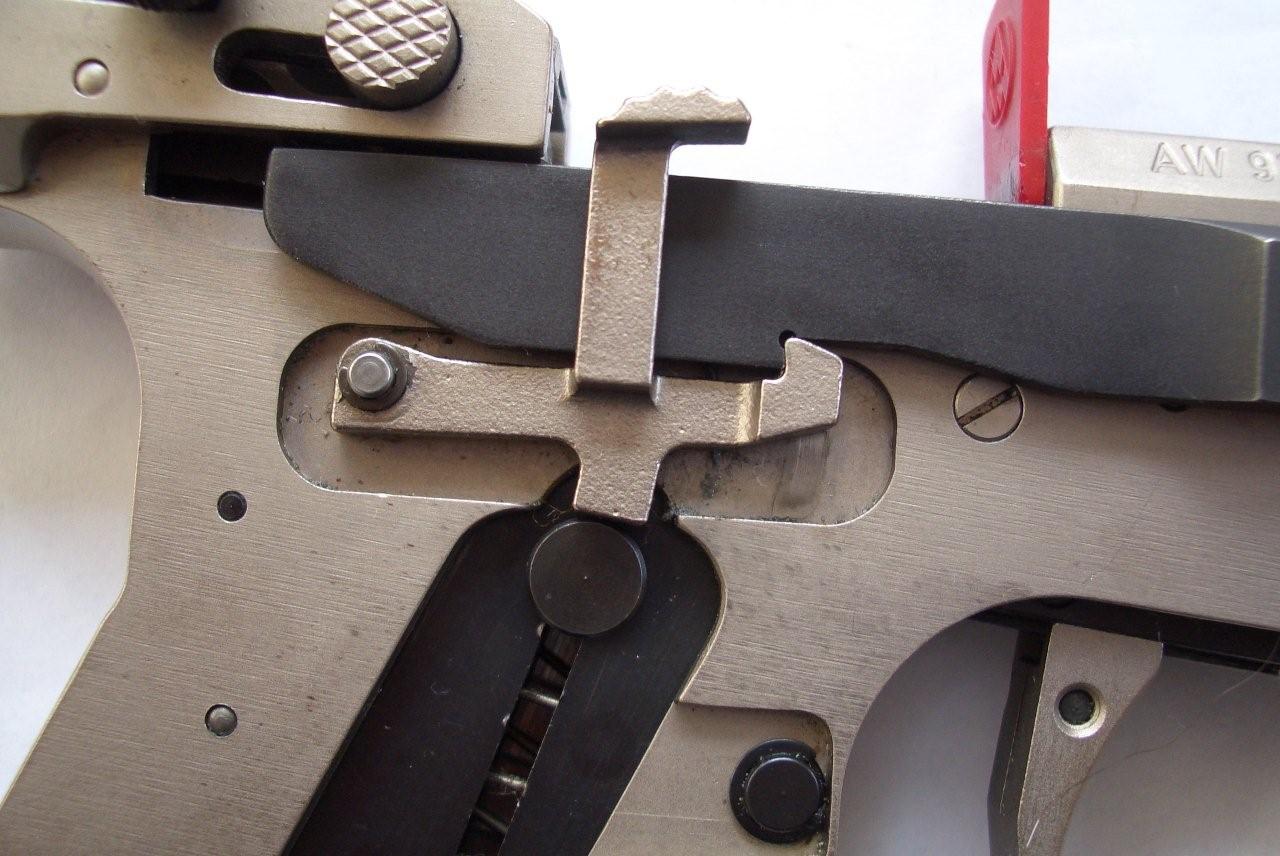

Yes - it's easily done.
You can either do it so it is reversible or something more permanent. The mechanism / lever which operates the hold-back on the last shot is on the right-hand side of the pistol. By taking off the grip all is revealed.
To make it easily reversible, simply remove the hold back lever mechanism by removing the little split ring which holds it onto its pivot. This also means that you will unable to manually operate a hold-back so you would have to revert to sticking a shell case in to hold the slide back for RO inspection.
If you still want to be able to manually operate the hold-back, the fix becomes more permanent as you will have to grind down the lower tab which is normally pushed up by a rising "button" on the magazine on the last shot to engage the slide. FWB would probably sell you a replacement lever if you then wanted to on-sell the pistol and didn't want to degrade its value too much.
AW93a shows the mechanism down. AW93b shows it having engaged the slide lock. Easy peasy.
