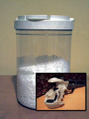

.....just wondering, have grips ever been made (successfully) out of other materials besides wood?
Susan
Walter
Posts: 101
Joined: Mon Mar 01, 2004 1:50 pm
Post by Walter »
I made one out of melting plastic beads.
And thenI bought one from Rink.

I just read about some slicone mold material. I was wondering if I could take a mold of the rink grips and thet use some of the melted plastic pellets. I also read about making a past of wood sawdust and some epoxy or airplane "dope" which I know nothing about.
