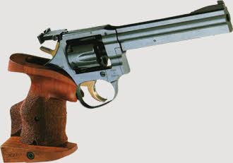

MANURHIN MR73 REVOLVER
MR73 MATCH
Revolver Type MR73 Match-blued
Model MR73 M-6"
Caliber .32 S. & W. Long Wadcutter or .38 Special
Barrel Length 152 mm 6"
Line of Sight 210 mm 8.27"
Overall Length 276 mm 10.87"
Unloaded Weight 1,080 g 38 oz
Model MR73 M-6"
- MR73Matchblued.jpg (7.43 KiB) Viewed 10181 times

One important spec is missing: what's the price tag? :-)David M wrote:MR73 MATCH
Model MR73 M-6"
Jim
