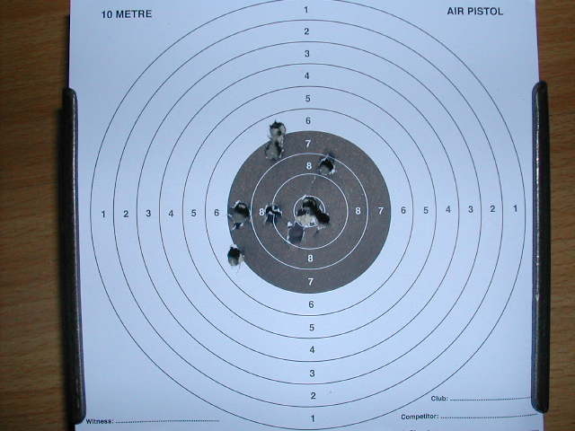

Advice taken
After the advice I shot a card, vast improvement on my last 100 shots.
- last card
- DSCN3363.JPG (43.17 KiB) Viewed 2093 times
