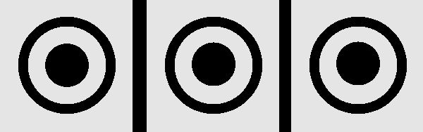

It's not so much about seeing a detail of 0.25 mm at 10 m. Rather, it's about judging the alignment of sights and the visual. That's a trick we are pretty good at. Similar to Vernier acuity.
Can you see it ...? See the figure below: from left to right, it's 10.9, 10.7 and 10.5 (the latter 2 being at 12 o'clock).
I grabbed these from a computer programme that I wrote which visualises sights in relation to the visual.
This programme can do several things. One of them is to briefly show a sight picture (might be a 10.9, might be worse). By means of a mouse click, you must answer: was it 10.9, or wasn't it.
After some trials, you can see a pattern developping. For what it's worth, I typically might mistake a 10.8 for a 10.9, sometimes I might mistake a 10.7 for a 10.9, but if it's a 10.6, I see it ain't perfect most of the time.
A second 'game' in this programme is where the target is plotted off-centre. By using the mouse, you can drag it until you think it's centred. Repeat several times, and again you get an idea of how well you can distinguish a 10.9 from something lower.
Here I typically score 10.80 or better.
If you're interested in playing with the programme, drop me a note (TT message) ...
Regards
Jeroen
Left to right: 10.9; 10.7; 10.5 (the latter two being off to 12 o'clock)
