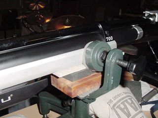

How does one one set up a vise for testing AP pellet grouping. It sounds like it would be very interesting to just see how the different pellets group. Anyone have any pictures or an explanation of how to set up the vise?

Basically the same thing I do with my FWB700 rifle anytime I decide to try a different pellet. The whole thing is sitting on an empty 55 gallon fish tank and the bench rest has fifty pounds of lead shot resting on it. You don't wish the gun or its support to move even 1mm. As for my target I simply place a clip on the bottom of it to which I add a small weight so that it does not move. Bottom line, once you are certain that everything is secure as possible you're all set to go.
