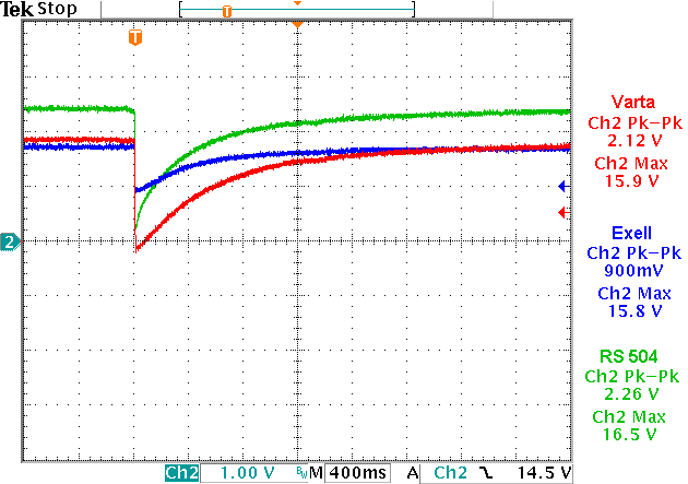

I've done some testing, and have been meaning to post the results when I had time to write them up in detail. I hooked up a digital oscilloscope to my pistol, and recorded the voltage waveform while dry-firing with a fresh Varta, both a fresh and a slightly used Eveready 504 (from Radio Shack), and a fresh Exell. The 'scope shows the voltage drop during the post-firing charging process, which is related to the internal resistance.
The Exell worked significantly better than the Varta or the Eveready. My only concern with Exell's is that they don't have any date code on them, so it's hard to tell how fresh they really are. I'd like to get more info on the Exell's, but Google says their web site is a virus source, so I haven't been able to find out things like their test criteria for their mA-Hr rating. The Exell is rated for more than twice the Varta, but a lot of that could be specsmanship.
The image below shows the voltage curves for the three new batteries. The voltage drop of the Exell is less than half that of the other batteries, and the recovery (charge time) is also much shorter. The starting voltage of the Eveready (RS 504) is a good bit higher, but it's a carbon zinc chemistry, and that will drop quickly once it's seen some use. Comparing an Eveready with 270 shots on it showed about the same initial voltage as the fresh alkaline batteries from Varta & Exell.
