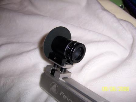

I was in a similar situation with my feinerkbau as I could not attatch anything to the front of it. I instead bought a 30mm sight extension tube made by gehmann. It attatches the back of it and from there you can attath you iris to it. If you can move your sight more forward and do this then it should help.

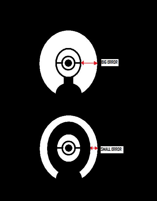

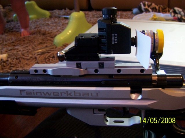

Here is something you can try. First observe in the pictures and then build you’re own. I made one up and o WHAT A DIFFERENCE.
PHOTO THROUGH THE SIGHT WITH OUT DISK.
WITH DISK

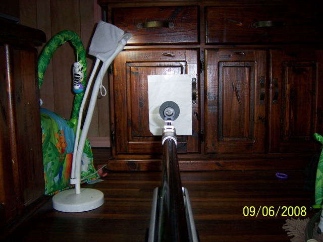

MADE IT FROM PLASTIC.

I like Brandon's concept. Along those lines, I've been talking to someone about manufacturing a 33 mm belled flange that can screw into an 18 mm Anschutz front globe sight. This will yield the same appearance as the Redfield International front sight.
For the rear, I've opted to go with a 1960's era Anschutz sight with a narrow, 45 mm long shade. This is a 1/6th minute sight and I found one essentially unused.
This setup is either a great idea or a total washout for reasons I've yet to discover. Brandon - What is the diameter of the disk you are using?

Mine is 46mm I just happened on that size when I was playing with the idea. I would suggest that you get a VIBRAKE from MEC. Its basically a bridge mount so that you can move youre sight forward and backwards like I can. You will see as soon as the light changes around you. You will need to move the back sight forward in low light and more backwards as the light gets sharper. The idea is to keep you’re “light ring” a consistent size. Mine is forward because of very low light in the house, I dry fire a lot. Play with the forward ring sizes between 40mm – 50mm and find the one that gives you the most optimum “light ring” size for you.

I agree. My coach drilled me on the rite cheek placement. I was one of those that just could not get the feel rite every time. After I added the disc I can confidently say I get it rite 1 out of 15 times. When I feel its out, I see it immediately through the back sight sometimes ever so slightly. I would just move my head away and start again and WALLA! I’ve got it. I set it that there is only a silver lining of light around it and I can tell you it is very sensitive to mistakes made by the head position.
