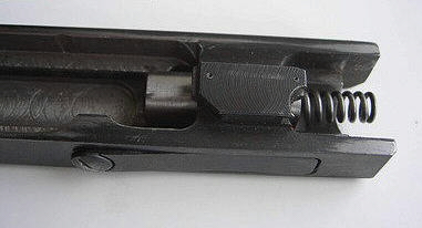

Reading online seems fwb aw93 lack of many things in front of his mother izh-hr-30. Several generic non detailed differences are addressed to feinwerkbau.
I'm wondering if the recoil sistem is different.

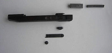

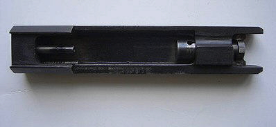

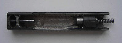

Below a pic of izh-hr-30 recoil part, last pics is a russian derived similar to aw93 ones.
Anyone else can post detailed pics of fwb aw93 for comparison?

Feinwerkbau aw93 recoil absorber VS Izh-hr-30.

I found this pics on russian forum, also Ruig was posting there. http://talks.guns.ru/forummessage/16/214493-2.html
From what i understood with google translator, it's ammortized sistem with screw regulation (lacking in aw93), and they talk about testing spring for use with selected ammo . The forum indicates also other minor fitting differences.
Steyr lp10 absorber's mass, don't have a similar retaining system and spring?

There is another set of pictures in that discussion thread, of the KhR-86. That one's absorber weight very much looks like the FWB's. I have an article about Kahidurov's pistols somewhere, where the author writes that the AW93 is based on the KhR-79 / KhR-82 design, so that could be about right. If anybody ever gets his hands on of those pistols, call me :-D

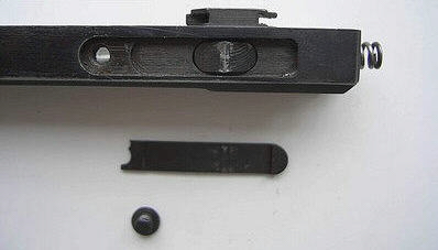

Here's the AW93 weight.
The larger absorber piston is hollow, with a guide rod in the center. the guide rod aligns the inner spring.
There is a metal plate under the piston which allows it to travel in its channel smoothly.
There is no adjustability to either the front or rear absorber springs, but a recoil spring can be cut down and used to replace the front spring pins, thereby allowing adjustment by removing the front screws and replacing the springs with a length of your choosing.
Feinwerkbau made the large piston spring and the front pair of springs work so they have similar compression characteristics under recoil.
