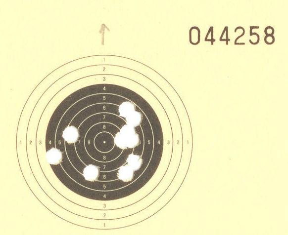

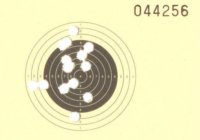

I haven't been paying attention to the scores. Internally, I am trying to make sure I pay as much attention to the front sight as possible and keep the sights aligned for every shot. Externally, I am trying to get my shots in the black. The last two sessions' shots showed a pattern: a vertical string of shots with some outsiders to the left, which are shown in the attached pictures. I think the string is there because my body is not used to holding the pistol up, therefore my vertical hold is bad. As for the outsiders, I think it's either the shot broke (by surprise) when the horizontal alignment happened to be bad, or because I was "sniping" the shots when the alignment was good, which disturbed my alignment. Does that sound reasonable? I think I'll set up my video camera and use it as a scope, and try to call my shots, so I can find out what I need to work on. One thing I have found out so far is that, as long as I keep my sights aligned, my hold can wobble in a big area, and my shots still end up in the black. Although getting in the black is not the same as shooting a 10, I think I kind of understand why sight alignment is the most important thing in a good shot.
Thank you for the information. I'll check that out and see if they have AP shooters there.
Bill:
Thank you for the advice. I have browsed through the Olympic Pistol forum and the Archive, and read most of the posts that caught my eye. Although many topics discussed are too advanced for me to understand now, I think some of them are greatly helpful for beginners like me. Following the recommendations from this forum, I have been reading the USAMU pistol guide and Yur' Yev's book. I've read some of the articles on our host's website, but found them in general more advanced than what I can appreciate right now. I hope I'll have a better understanding of them when I revisit them after a while. Is the Russian coach you mentioned Anatoliy Piddubnyy?
- 15 shots on AP target
- 044256.JPG (28.39 KiB) Viewed 1777 times
- 10 shots on AP target
- 044258.JPG (28.62 KiB) Viewed 1778 times
