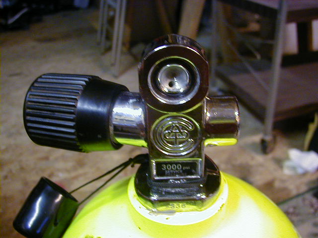

I just bought an FWB P34 and I found a reasonable scuba tank at my local dive shop. The problem is that I must need some kind of adapter on the tank to put the cylinder adapter on. Can someone point me where to get such an adapter.
PS - I don't see any screw thread type things on the tank.
Thanks - Jim

What did the tank come with? Depending what it has you can get a 200 bar k-valve, or you can get a Din Valve installed. Best bet is to take you fill adapter and you tank to a dive shop and see what you need.

This is what is on the tank.
Thanks - Jim

Jim, You need a K valve as pictured in our hosts site.
