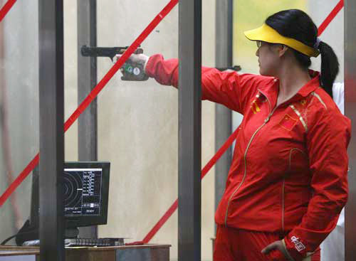

Here's an image of Chen Ying on her way to winning Gold in 25m Pistol at the Beijing Olympics. Can anyone identify what her pistol is?

i thought it looked like a Hammerli 208
if its not, let me know I posted that on another forum I'd need to correct
maybe itsa model 41
what was Gundegmaa Otryad using? the magazine loaded into the pistol from the TOP (watch the finals video)

Not a 208 and not a 41.
I have no idea. I blew it up and the trigger guard is square.

if it was a 208 I think the slide would soon make short work of the top rear of that grip

Most likely a replica of one of the Khaidurov prototypes.
Reasons for my guess:
1) Kinda looks like one (XP-30 ?)
2) Clearly not anything that's on sale.
3) If "made to order" - Khaidurov design is an obvious choice.
Could be a Chinese design built from scratch (since they now use their own ammo too, so it is not too far-fetched); However, that is not Chinese modus operandi, if you know what I mean.

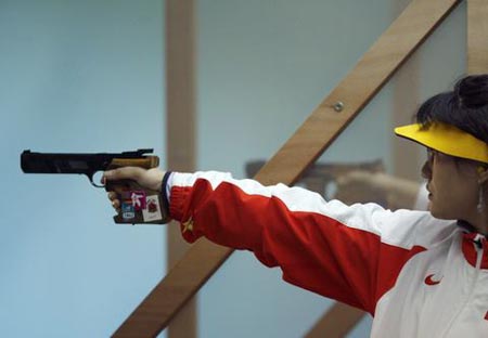

I've just found another photo of it from when she was at the ISSF World Cup shoot in Munich last year. This image is much clearer - but I'm none the wiser...

It's a chinese pistol. I used to know the model number but have forgotten.
There is at least one here in New Zealand as I used to know the guy that was the owner. Has since been sold and I don't know who has it now.
I think that they had a little lever (like an air pistol) which would re-cock the hammer without having to rack the slide.
If it is the one I think they have been around since about the late 1980s.

Chen's pistol is not just an IZH-35M with Morini grips is it?

ColinC wrote:Chen's pistol is not just an IZH-35M with Morini grips is it?
I don't think so. The back sight f the IZH is a good deal deeper on the IZH then the one on Chen's pistol. Here's a side view of the IZH:
As you can see there are a good few differences.
It's a Chinese produced pistol. Read my previous post!
