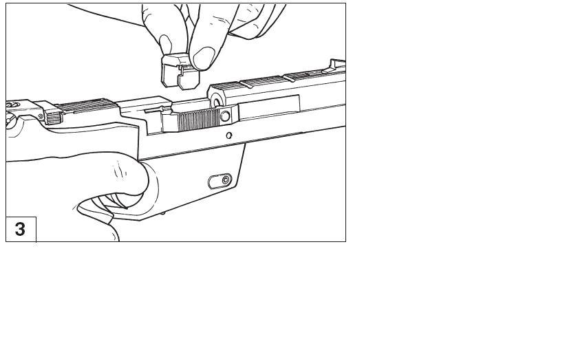

What is the intended use for the "Blank test spacer" part code 064P for the Benelli MP90S/MP95E. It looks like it might be a dry-fire adapter but there is no mention of use in the user's manual.

If you're referring to the red plastic piece, that's exactly what it's used for.

It is not a chamber plug/snap cap but is pictured in the picture below from the manual if it's red plastic then yes that is what I mean.

That's exactly the piece I mean. When it's inserted, it keeps the slide out of battery, and when the trigger is pulled, the hammer moves forward a very short distance, doesn't reach the firing pin, instead, striking the body of the slide. That's why you only have to bring the slide back about 1/4" to re-cock it.

I didn't receive one with my pistol and I was hopeing that is what it did.
Seems to be a nice solution for dry fire practice.

Yes, I use mine for dry firing all the time. If it's not available from Benelli, it should be easy enough to make. It doesn't need to be tunnel shaped, unless you want to leave your magazine in, just able to fit down between the slide rails, with a clearance notch for the extractor. The length, front to back, is .550". This may be important because it determines where the hammer contacts the bottom of the slide.

Fred, That ECI won't work with the Benelli, because the ejection port is vertical, and the tab would have to be removed so's not to interfere with sighting. The rim of the brass "case" would have to be removed in the extractor area to be able to cock the pistol without it being ejected. The shape of the ejection port/cocking bosses on the Benelli is such that any 1/2" cube could be used, such as a die(half a pair of dice).
