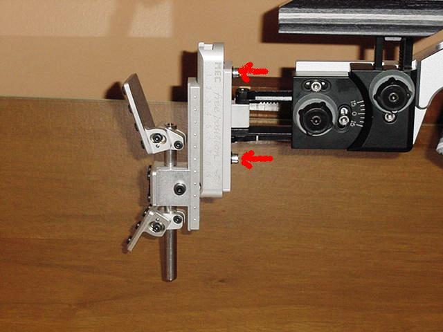

I feel the same way about the butt plate as pwh do and most people i know or see in competitions have replaced with MEC (me too). The thing that i dislike about it is no rubber on the bottom part and a bit too width in general (my opinion of course). But that is how it works when you get a rifle, adjust it to fit and then fix the problems that is built in or just don't suit you. The most important thing is to like it from start and which make it is isn't.
If I get the time I'll try to take some pictures of how I did it. Other than that its not at all really hard to do. You simply have to buy a few machine screws and nuts. If you take the time to look it over closely you'll easily figure out just what you need to attach it on.Slowstdy wrote:I have a FWB 700 alu, and would love to replace the but plate with a MEC. How do you fit the MEC but plate to the FWB's. If you can a picture would do.
~Phil
This may not tell you too much as for the picture but, I didn't feel like removing the butt plate. I simply measured what size and length of Allen head machine screws that I needed. I also have a washer underneath the heads of the two Allen head screws that you can see in the picture. Its been sometime since I placed it on but I'm quite sure that I also have a washer and a lock washer on the other side (inside).
Bottom line, its only the two Allen head machine screws with the appropriate washers and lock washers. Very simple to do. Most hardware stores will have a large assortment of metric machine screws. Hope this is of some help.
~Phil
~Phil
