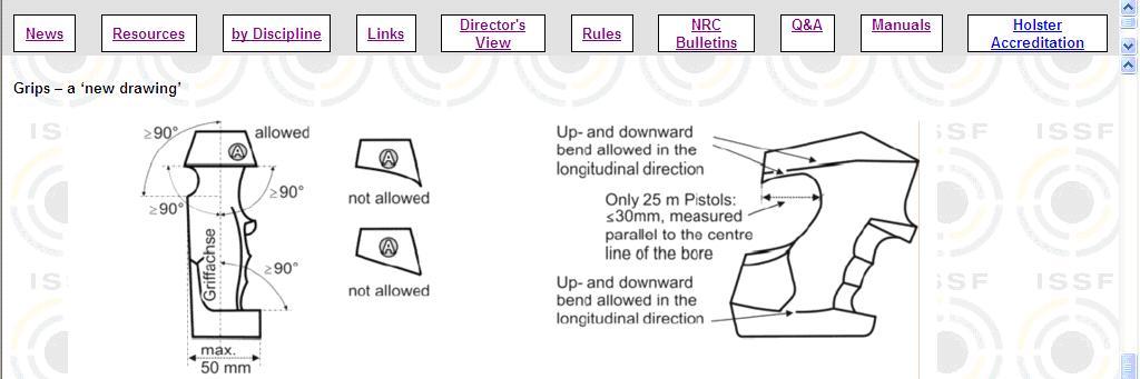

See the attached diagram from the Australian National Referees Association website, http://www.users.bigpond.net.au/nrc_pa/default.htm.
While overall, the ends of the grip appear to begin and end at the same level indicating 90 degrees from the vertical axis of the grip there is clearly an upward and a downward curve see rule 8.16.0 note a.

Now, on the basis of the above diagram, why would this un-modified Rink grip be legal if the angle is slanting downward?

Walter wrote:Now, on the basis of the above diagram, why would this un-modified Rink grip be legal if the angle is slanting downward?
A definite maybe...
this looks as if there would be 'downward curvature' in most shooters' hands on the right side, and should draw attention from an effective Equipment Control officer and/or competitions on the range.
For a shooter who holds the pistol off-centre (in this case, hand rotated anti-clockwise when viewed from above) the grip could be OK
A definite maybe...
Further, the part of the grip not in the photo may be shaped such that the griffachse does not correspond to the line of the laminations
A definite maybe...

The griffachse does correspond to the lines of lamination.
Most Rink grips that I have seen, have this downward curve of the grip, therefore I assume that most Rink grips are in fact illegal by the standards of the rules.
Unless I am mistaken (which I very well may be), years ago the rules had the curvature specified in millimeters of the downward slope. If I remember correctly it was 5mm?.
The rules plainly state that there should be NO slant to the grip in relation to the griffachse.
Walter wrote:Unless I am mistaken (which I very well may be), years ago the rules had the curvature specified in millimeters of the downward slope. If I remember correctly it was 5mm?.
Not as far as I can remember (may be before my time) and certainly not in the last 15 years. I'm afraid my rule books before 1993 have gone walkabout.
Walter wrote:The rules plainly state that there should be NO slant to the grip in relation to the griffachse.
No downward slant in relation to the part of the grip we are discussing. Upward slants in that area are OK.

Just checked my factory Rinks (the one in the picture looks like a custom job) and all of them are pretty much horizontal in the part above the hand. So don't start any rumours. Every gripmaker worth his salt knows the rules and will stick to them, but of course the customer (and his ideas of what is allowed) will always come first... AFAIK the current book doesn't contain any 5mm rule, it's simply that no downward curvature is allowed. On the other hand, I've rarely seen the point discussed in equipment control except in obvious cases. And the Rink grip pictured is IMHO very far from obvious (unlike the one at the beginning of the thread) - the left side is ok anyway, and the right side does not show any downward turn, it's just that the point where the upward turn begins is somewhat right of the middle, and the interpretation of "middle" depends on a lot of things.
PS: The rear sight does not automatically define the horizontal - check out any FWB P44, or Morini CM80, or some other custom jobs...

I have a Morini CM22M RF Rink grip made in April 2008, so a newly designed grip (its specific for the new CM22M RF and doesn't fit on the normal CM22M), not an old one, that shows exactly the same shape as on the showed picture:
I was already wondering if this grip is legal. On the ISSF rule, the straigth and concave line cases are shown and judged illegal.
The convex line case as on the Rink grip is not shown, it is unclear for me if this is also illegal.
The rule says 90 degree but for a curved line, what does 90 degree mean ? If it is the angle of the tangent to the curve, then the angle of the tangent to the convex shape of Rink is at 90 degree and is legal while the angle to the tangent to the concave shape showed on the ISSF rule is indeed illegal.
jipe wrote:The convex line case as on the Rink grip is not shown, it is unclear for me if this is also illegal.
Unless you hold the gun in a very unusual way I would say that your grip is illegal.
It really depends on how you define the exact position of the "Griffachse". That needs to be the lowest part.
