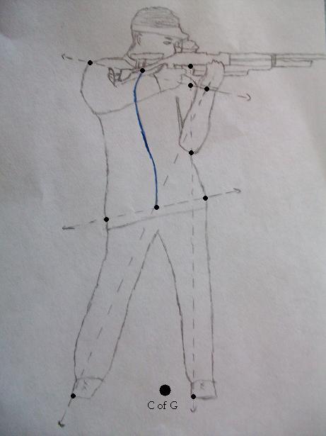

i drew a picture of Torsten Krebs' position from the book Air Rifle Shooting because it shows a good static position with all the basics. take note of the hip position; they should tilt upward toward the target, and this (at least from my experience) will be the main influence of weight distribution among the legs. the center of gravity is ideally about half way between the left foot and the midpoint of the two feet.

Hello xcrunner8k and thank's for your reply.
I've seen this photo and although I tryied to copy it and fix ny position according to the photo,it didn't work for me.
Somehow,the riffle aimed to high(that is with the buttplate all the way down to the ISSF limit...)
