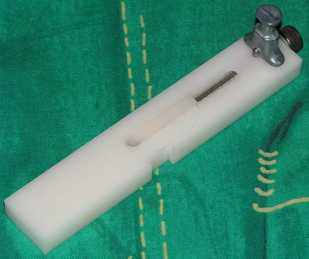

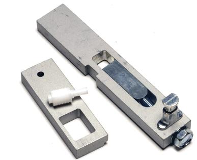

Anders Turebrand
Posts: 82
Joined: Fri Mar 26, 2004 6:27 pm
Location: Stockholm Sweden
Post by Anders Turebrand »
The Dillon X-small powder bar differs from the small only in that the end of the dispensing cavity is flat instead of triangular.
In my opinion it has a too wide adjustment slide (about 10mm or 0.4") which has the effect that the dispensing cavity becomes very narrow when you adjust it to small charges, say less than 1.5 grains.
It seems that some powders will sometimes stack in this narrow space giving a smaller load in that instance.
I personally haven´t weighed charges but a friend ("Axel" on this forum) did maybe two years ago and he found occasional light charges using N310 with a small charge, if I remember correctly 1.3 grains, with lighter charges being around 1 grains.
We talked about this and I made a powder bar from delrin (polyacetale) with a 6mm (0.24") wide, round ended opening and a flat ended adjustment slide with an M6 adjustment screw (close enough to the original ¼" screw to work with the locking piece after turning a slot in it)
Axel tested this one with good results, in fact he did not want to give it back to me...
So I made another one with a 5mm (0.2") wide, round ended opening and an adjustment slide with a circular cutout in its front which means that the dispensing cavity is circular when set to about 1.1 grains of N310.
I did choose to go to a M4 adjustment thread on this one which meant a little more lathe work turning it from an M6 screw.
This one works very well for small charges of N310 (that´s what I have tried) and probably with other powders as well.
Anyway, I have included pictures that show (hopefully) what I mean.
-Dillon1 is an X-small powder bar
-Dillon2 is a comparison small/X-small
-ultrasmall is my second try
Sorry for a lenghty post...
/Anders
