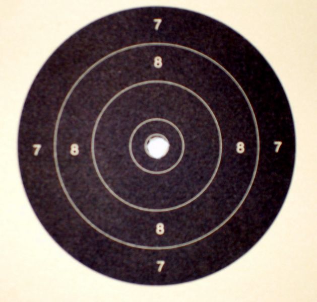

Post by jacques b gros »
Guess this was almost at the middle of the "shake" area... ;))
SDC10691-1 [800x600].JPG (42.34 KiB) Viewed 2701 times
