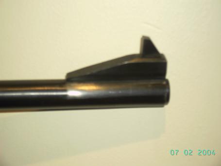

Where is the band
PICT0177 smaller.jpg (16.84 KiB) Viewed 3195 times

Shooting Kiwi wrote: can just make out the join between barrel and 'band': the band is about 17.5mm long. .
muffo,
Didn't you read that bit by "shooting kiwi"
Look closer and re-read the other posts. It has been skillfully blended into the same diameter as the barrel. They just didn't bother blending the 35M (as I've already tried to tell you!).
But, you know, you've just got your first TOZ so you probably know more about them than me as I've only been using and modifying them for 23 years.
toznerd
Post by toznerd »
As shooting Kiwi and J-team state, it is a band that extends back to a line that encircles the barrel, just below where the serrations on the front sight ramp begins. If you remove it with heat, make an attempt to control the heat. Apply the heat to the ramp and band and use heat soak paste or wet rags to prevent overheating the actual barrel. Take a lot of pictures and keep us posted how it goes.

You are both right and wrong I have just got my first toz and i dont know more than you as really i know pritty much nothing about pistols. So what you guys are saying is just at the back of the sight ramp is the join but its not actually vissable. this would explain the slightly different colour you can see in the photo. I wont do the heating my self my father will do it as he knows what he is doing. Do you think it would be bettter to leave the sleeve on and cut the sight off seen the outside diameter is the same size as the morini

Is this any clearer?
If you just saw it off you will be left with a groove in the top of the barrel behind where the band stops. This groove (below the ramp) is to keep the sight body aligned vertical. Part of the ramp extends down into this.

crystal. dam thats a pain
