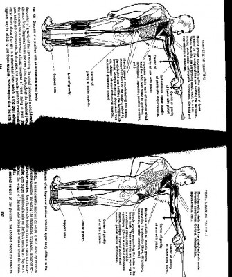

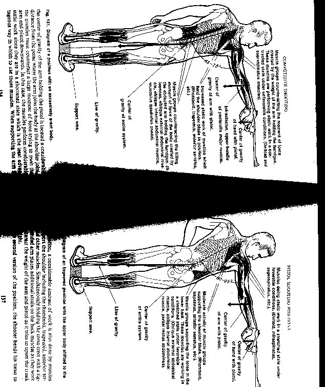

I keep reading bits of the Yur'yev book and one thing that is currently filling my brain is the section on stance. For those of you who dont have it the relevant section is attached. Which do you use? Basically upright, or deliberately leaning back, more than the minimum that you have to?

It's not supposed to give more support, but the theory (backed up with included research) is that in that pose, the deltoid and supporting shoulder muscles are longer, and this makes them more effective at performing static work. The result being that they twitch less, and gives you a more controlled hold.

4. Most importatnly perhpas- you must realize that many of the digrams/pictures in the book are "exaggerated for emphasis." Yur'Yev points this out a couple of times explicitly in the book. When the poses/diagrams *aren't* exaggerated (like the foot position charts) it actually merits special mention.

4 - I do realise he exaggerates for emphasis, but in that diagram he includes specific angular measurements (in a range, but gives an idea of the additional change in angle). I guess I am asking - Fig 142(i), or fig 143(b) ? They are pictures, factual images (!), of the same shooter in different postions.
