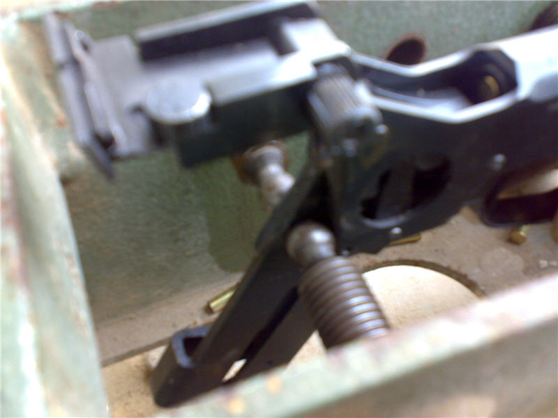

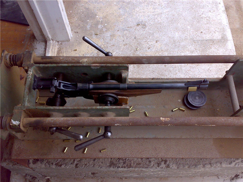

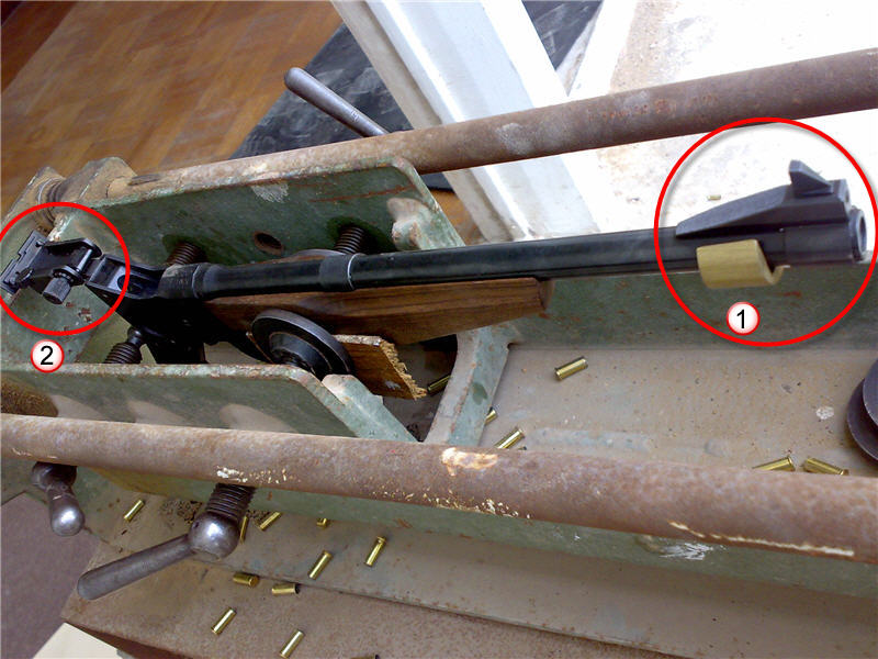

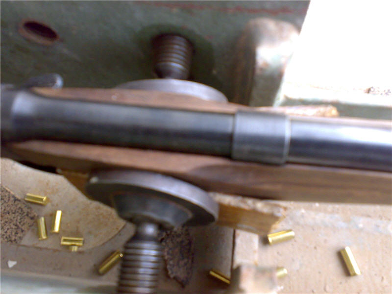

Chris wrote:Has anyone put a Toz in a ransom rest?
How did you do it and do you have pictures to share?
if that like what i understand for i used the rifle ransom rest !!
like my photo bellow.........
toz35
toz35
