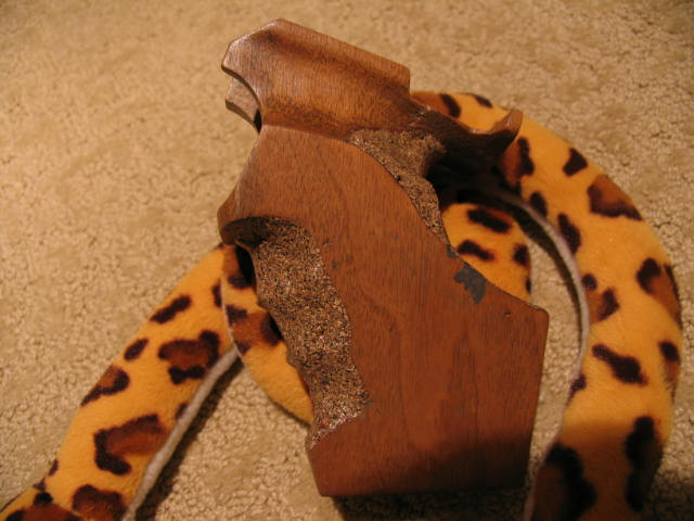

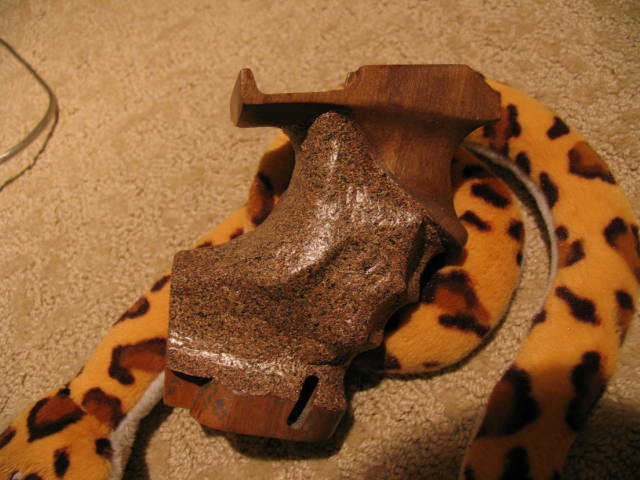

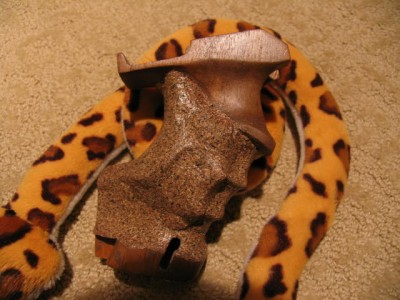

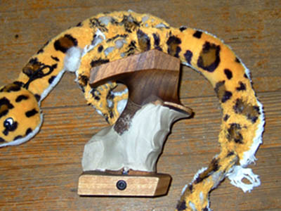

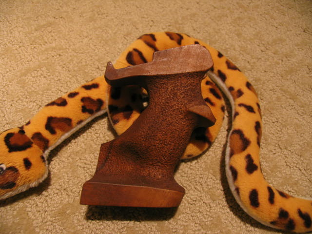

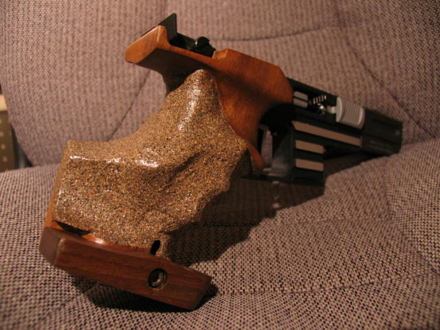

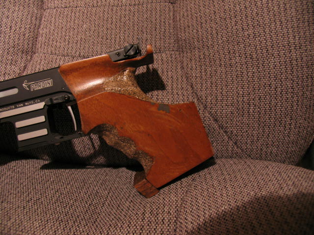

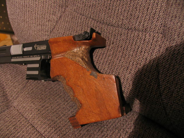

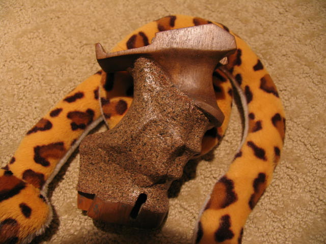

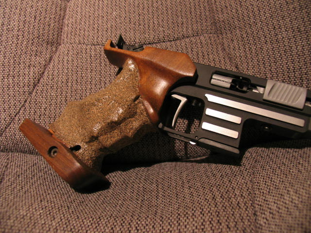

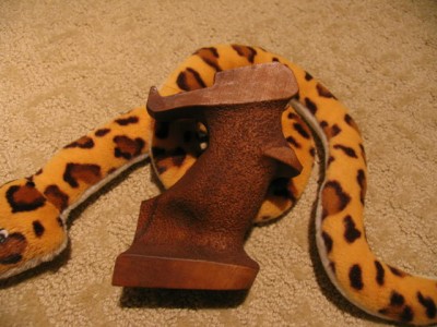

Not being averse to altering a finely made grip by grinding and filling, I am left with a less-than-appealing vision,and so far have just lived with it.There is a Home Depot spray can called "stone" which is a high-build texture coat for creating a stone-like appearance,with a fine stipple texture,on household items , such as vases,etc.The pictures tell the story.The product is coarse enough to cover any less than perfect finish in the affected area. I sanded the remaining original surface,masked off with tape,and applied one coat of the "stone"...an instant transformation.Followed up with 2 light coats of satin polyurethane to complete the job. While admittedly not as striking as a fine piece of tung-oiled walnut,it's a helluva lot cleaner than the bondo special...your opinion may vary.
standard grip that doesn't fit

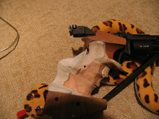

grip after bondo,moleskin,grinding,etc
grip with texture and polyurethane
other side
other side
finished product
finished product

thanks,the snake is the dog's favourite toy... I am thinking of using a matt oil finish to bring out more woodgrain, and an acrylic coating over the texture,as the solvent- based polyurethane smoothed out some of the texture a little.
solomon grundy
Post by solomon grundy »
Wow - nice job. How does the surface feel? Is it gritty?
superstring
Posts: 155
Joined: Thu Sep 09, 2004 4:16 pm
Location: Victoria, BC Canada
Post by superstring »
Would you be able to strip the polyurethane without affecting the "stone" finish or would the whole job need to be done again? How would the stone finish with no top coat work out?
jsealc21
Posts: 187
Joined: Sun Aug 20, 2006 8:35 pm
Location: Temecula,Ca
grip
Post by jsealc21 »
If I used a lighter coat of acrylic finish ,instead of the urethane,there would be more texture. The existing texture was diminished by too much urethane. The texture coat ,I feel, needs a surface cover for longevity. With regards to stripping,it's so easy to mask with tape,I'm going to strip the whole thing and start again.The existing finish is not as gritty as a factory stipple,but much better than smooth finish. We shall see what plan "b" brings.

As described in previous post, I redid the texture,and the finish.The texture is "mild",but may be increased by using "sharkbite" , a floorpaint additive from ....Home Depot,applied after the texture spray,and before the final matt acrylic.

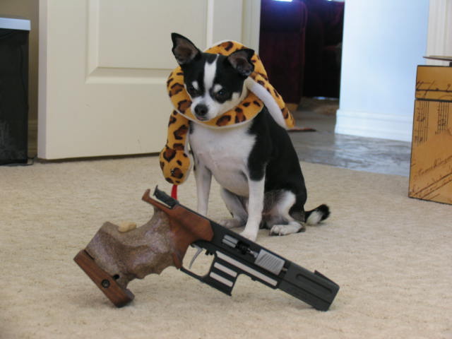

Benson,the snake killer, withhis newly renovated "snake pistol"
