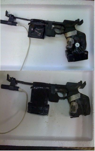

For 6 months I have been using the pistol below to shoot air through a SCATT. The best score for the 6 months was 560 and I was lucky to get it. Generally I shot somewhere between 530 and 545. Now I use the term pistol loosely because I put it together from bits and pieces in the garage, a grip from a 22 and a trigger assembly from hell. The gun weights 1.2kg and the trigger pulls 650gms.
Now take the same person, same gun and just move the weight from the grip to in front of the trigger and add one day; I shoot a 583. A fluke? For the past 3 days since each match has resulted in a 580+.
Why?

- Before n After.jpg (30.83 KiB) Viewed 6449 times
Interesting comment. Although it begs the question - if you can improve your score by 20 points instantly by adding weight to the front end why don't most shooters add the weight and well... grin. Maybe their new Popeye forearms would give them away. No offence but surely there has to be more to it than that.
Steve - I've got to fess up - the gun doesn't shoot anything but infra-red. The barrel has a depth of about 3mm. I'm also shooting at a reduced distance with a scaled back target size (Scatt automatically measures the distance and allows you to print scaled targets - nice feature). I left the sport 5 years ago - detailed in another post - but shot for 14 years before that and shot at a lot of competitions over those years and was never aware of the "anchor syndrome" - maybe I should have taken a keener interest in what was happening around me.
Bob's comment is an interesting one and if correct adds another expense to shooting - that of therapy or equivalent. I would hate to think the 20 point difference in score improvement detailed above (probably greater if you take my previous average into account) is due to head south like the stock market purely because my head won't be able to handle it. I know what it feels like to be in a competition, one shot to go, you only need a 9 to win the competition and as you raise the gun the thought "I surely don't want to shoot an eight about now" comes to mind.... but dropping 20+ points... maybe more weight ;)
Maybe it just has to be the weight - perhaps I just lucked onto the right amount of weight placed in the right position for that gun. Maybe each gun has some optimal combination for both. I would like to experiment further but am enjoying my newfound honeymoon period too much... I might be forced to later if Bob is right.

I documented a situation similar, early in my AP shooting career -about months ago ;-)
I was working to build up muscle/stamina and thought I was being so clever by taping a tin of pellets to the front of pistol.
I did this for about 6 weeks. My scores went up quickly. About a week before a PTO, I took the tin of pellets off believing I was about to add a bunch of extra points to my score.
Unfortunately, what I saw was the front sight bouncing and dancing around like I was on a pure caffeine diet. Needless to say, my scores dropped for a while. They did return after a week of hard work without the weight.
It could be that you and your scores are better with a nose heavy pistol. It's simply easier for you to shoot.

Some of it is muscle tone, strength, etc., but some of it is simple physics.
A pistol wobbles due to motion in the wrist, elbow, shoulder etc. If you twitch, it imparts a force to the pistol. The pistol will accelerate proportional to this force, but the acceleration gets divided by the mass of the pistol. For rotational forces, how fast the muzzle swings gets divided by the moment of inertia, which is a function of mass, and how far the mass is from the pivot point.
You may not be able to hold it up stably due to muscle issues, but for a given mass (weight) of pistol, the more you can park as far forward of the pivot (i.e. the wrist), the less it will move for a given disturbing force. The trick is finding a weight distribution that maximizes the stability of your hold for a full match. This will be when the mass is as far forward as possible without increasing muscle strain or fatigue to the point that the disturbing forces grow more than the increased moment of inertia suppresses the resulting motion.

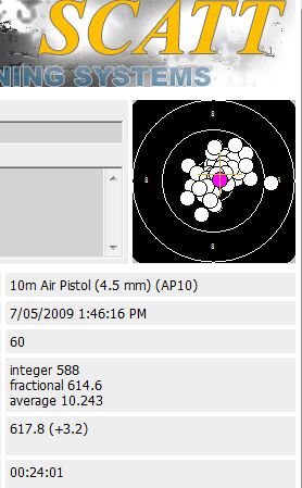

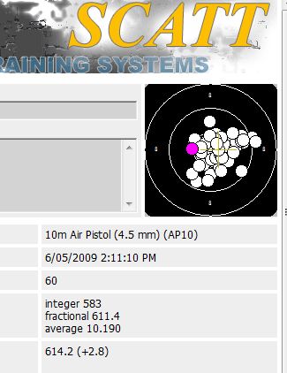

Thanks to those people who posted a reply. I just finished another AP shoot - the first since my post yesterday - a 589 (proof attached). It has to be the weight brought forward - I don't care anymore I only know I love it. The real fun starts when I get my own AP in the next 6 weeks or so - hopefully it too will have a sweet spot for a little extra weight. Then its a matter of going out to the range, facing off to a real target at 10 metres with real pellets and seeing if I can duplicate some of these scores.
- scatt2.jpg (25.55 KiB) Viewed 6133 times
Keep us updated.Pabs wrote:Thanks to those people who posted a reply. I just finished another AP shoot - the first since my post yesterday - a 589 (proof attached). It has to be the weight brought forward - I don't care anymore I only know I love it. The real fun starts when I get my own AP in the next 6 weeks or so - hopefully it too will have a sweet spot for a little extra weight. Then its a matter of going out to the range, facing off to a real target at 10 metres with real pellets and seeing if I can duplicate some of these scores.
Do you adjust the sights during a "match" or just go with the same setting from practice to practice?

SCATT though has the facility to move the last shot - a case of click and drag. If you shoot a good shot - you know it when you have one; it feels good - but if it is off to the left you click and drag it (the actual shot) to where you think it should have gone. My system seems to remember where it was from the last session. I have not had to purposely change it for the last couple of weeks. Lately I have been shooting the same set up whichever match I am shooting (SCATT offers lots of matches - don't get me started on Centre Fire - I love it).
deadeyedick suggested I move my sights a click or two left - if you look at both printouts he is absolutely correct but I chose not to. I want to leave the setup as it is to monitor my performance... well, until my new gun arrives.
Updates - if you are interested why not. Although if Bob from Richmond is correct - it could be very embarrassing. If you want to post your email address as a reply I'll send you a weekly update
Area aim is the only adjustment my "gun" has ;)
