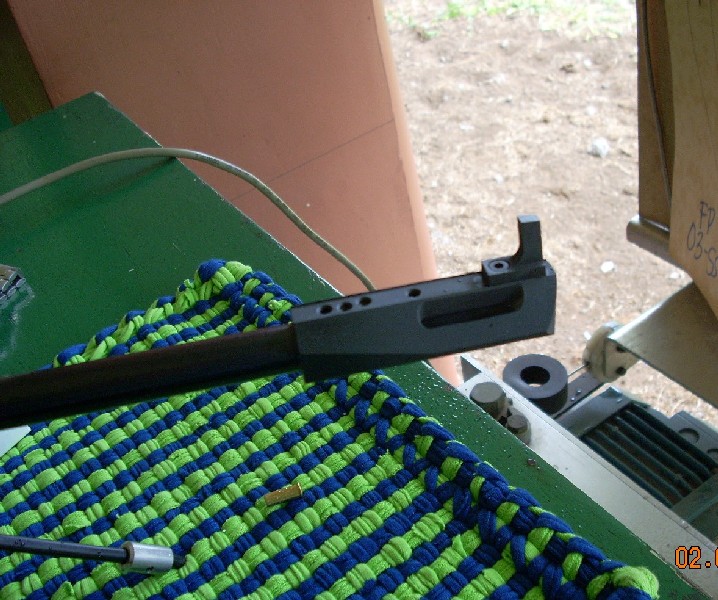

This is a shot of the compensator on my MG-5.

So far I have been really impressed with the MG5. My MG5 is a mechanical trigger and is very crisp. I have no reliability problems with it and I think it is pretty light. My compensator is the same as Jack's. I compared the MG5 with the new Hammerli and in my opinion I came out the far superior free pistol by buying the MG5. It is getting harder to find a mechanical trigger free pistol. Before this I was shooting a Morini CM-80 Supercomp which I still really enjoy shooting.

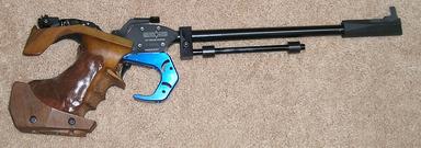

This is Ernie's MG-5. I posted the image he emailed to me (without asking permission). I resized it for posting.

Way to go Jack!! The trigger is from Match Gun Company and I altered it for rearward position.It is much further to the rear than a stock trigger and it helps me pull trigger" straight to the rear" and reduce lateral errors while releasing the shot. The weights are from a CM84E and fit perfectly.The rear weight is adj to reduce any vibration from rod and the front weight varies the balance. Between the muzzle brake and weight system the pistol hardly moves when firing-not that this is too important in FP shooting.

I really like how you put the CM-84E weights on the barrel. Did you get the new modified 3 piece trigger mechanism working correctly from Matchguns? I still have a 2 piece trigger mechanism on mine but for the mechanical trigger it does not seem to be causing any problems.

Weekend Shooter wrote: My comp is the black flat type.
The picture from Jack shows a blue (older version?) compensator with a flat bottom.
Your gun has the same black compensator as my MG5E.
The upper part of your compensator (to the rear of the gas ports) are flat, but to small for attaching glue-on wheel rim weights.
But your compensator is not flat-bottomed, "Weekend Shooter"...:-)
